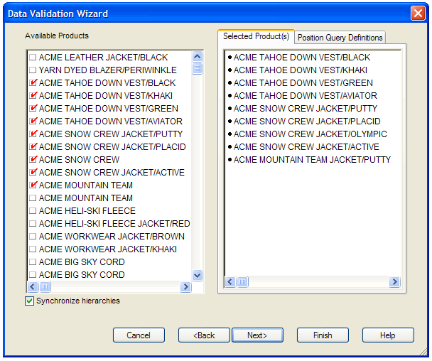

To build a Data Load Validation workbook, perform the following steps:
Click the New icon in the toolbar.
The New Workbook dialog box appears. On the Item Planning Administration tab, select Data Validation and click OK.
The Data Validation Wizard appears at the Select Calendar step. Select the weeks you want to validate and click Next.
The Select Product step appears. Select the products you want to validate and click Next.
The Select Location step appears. Select the channels you want to validate and click Finish.
The Data Load Validation workbook is built.

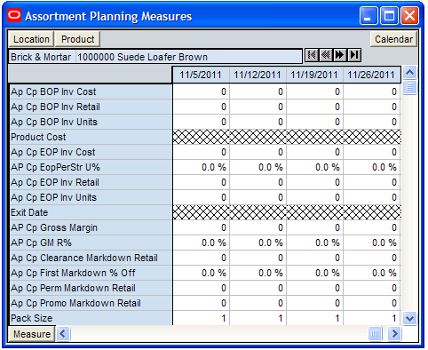

Use the Assortment Planning Measures worksheet to validate that the Assortment Planning data was updated in the batch process.
Table 10-4 lists the measures available on this worksheet.
Table 10-4 Assortment Planning Measures
| Measure | Description |
Ap Cp BOP Inv Cost |
Assortment Planning Current Plan Beginning of Period Inventory Cost. |
Ap Cp BOP Inv Retail |
Assortment Planning Current Plan Beginning of Period Inventory Retail. |
Ap Cp BOP Inv Units |
Assortment Planning Current Plan Beginning of Period Inventory Units. |
Product Cost |
The cost of the product. |
Ap Cp EOP Inv Cost |
End of Period Inventory Cost. |
AP Cp EopPerStr U% |
Assortment Planning Current Plan EOP Per Store Unit %. |
Ap Cp EOP Inv Retail |
Assortment Planning Current Plan End of Period Inventory Retail. |
Ap Cp EOP Inv Units |
Assortment Planning Current Plan End of Period Inventory Units. |
Exit Date |
Date that inventory should be removed from sales floor. |
AP Cp Gross Margin |
Assortment Planning Current Plan Gross Margin. |
AP Cp GP R% |
Assortment Planning Current Plan Gross Profit Retail %. |
Ap Cp Clearance Markdown Retail |
Assortment Planning Current Plan Clearance Markdowns - Price reduction used to clear aged or slow moving inventory at Retail. |
Ap Cp First Markdown % Off |
Assortment Planning Current Plan Initial Markdown Taken expressed as a rate. |
Ap Cp Perm Markdown Retail |
Permanent Markdowns representing a permanent retail decrease to the owned inventory price of merchandise for strategic downward re-pricing decisions at Retail. |
Ap Cp Promo Markdown Retail |
Promotional Markdowns representing the temporary reduction to the owned inventory price for promotional purposes expressed at Retail. |
Pack Size |
Quantity of style / color or styles purchased from Supplier as a pack. |
Ap Cp Clearance Price Change % |
Assortment Planning Current Plan Clearance Price Change %. |
