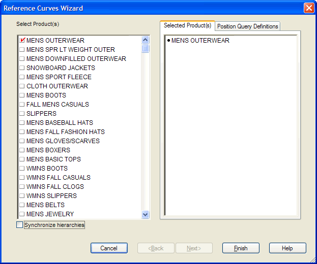

The Reference Curves Wizard appears at the Select Products step. Select the products you want to create curves for and click Finish.

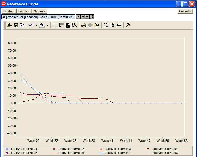

Use the graph view to see how the curves look over the sales period (Figure 3-4).
