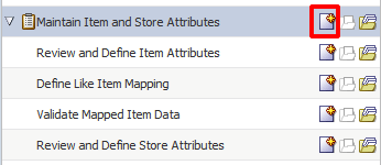

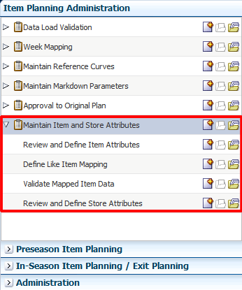

5 Maintain Item and Store Attributes
The Maintain Item and Store Attributes task allows you to map history and validate the results of mapping the history of a single item to a new item. This action provides a regular unit sales curve and quantity for reference when seeding and planning regular sales units.
The Maintain Item and Store Attributes task contains four steps:
Figure 5-1 Maintain Item and Store Attributes Steps

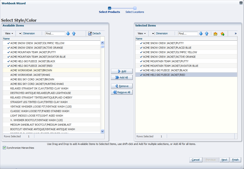

  1. Click the New Workbook icon in the Maintain Item and Store Attributes task.
    Figure 5-2 New Workbook Dialog Box
  2. The wizard appears at the Select Style/Color step. Select the style-colors you want to map and click Next.
    Figure 5-3 Item and Store Maintenance Wizard: Select Style/Color

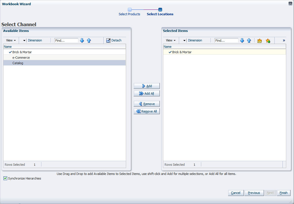

  3. The Select Channel step appears. Select the channels you want to map and click Finish. The workbook is built.
    Figure 5-4 Item and Store Maintenance Wizard: Select Channel

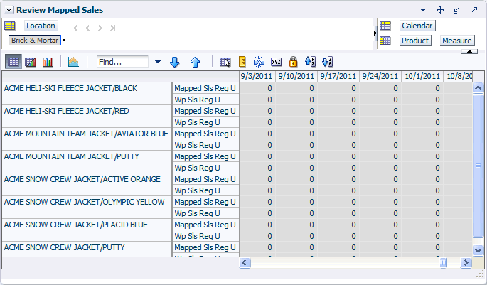

Validate Mapping Step
The Validate Mapping step contains a single view called Review Mapped Sales.
Use this view to review the items and item histories of the items that you mapped in the Define Like Item Mapping Step.
Figure 5-8 Review Mapped Sales
Table 5-3 describes the measures in this view.
Table 5-3 Review Mapped Sales View Measures
Measure Description
Mapped Sls Reg U
Mapped history for regular sales units.
Wp Sls Reg U
Working plan for regular sales units.
