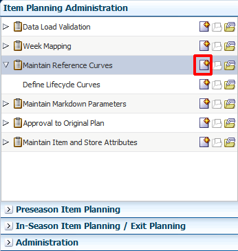

To build a Maintain Reference Curves workbook, perform the following steps:
Click the New Workbook icon in the Maintain Reference Curves task.

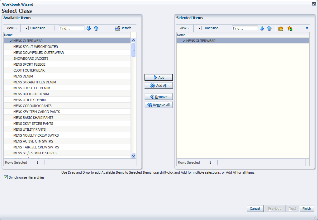

The Reference Curves Wizard appears at the Select Class step. Select the products you want to create curves for and click Finish.
The Maintain Reference Curves workbook is built and opens at the Maintain Curve Profiles View.

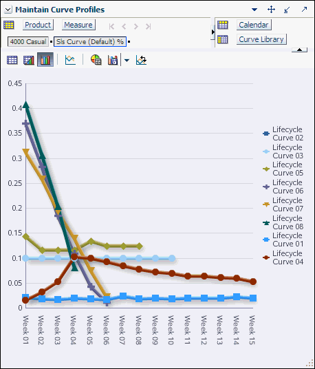

Use the graph view to see how the curves look over the sales period (Figure 3-4).
