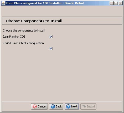

The Choose Components to Install Window opens.
Select one or both of the following options:
Item Plan for COE Server — Select this option to install the Item Planning Configured for COE server with the domain.
RPAS Fusion Client configuration — Select this option to install the RPAS Fusion Client configuration for Item Planning Configured for COE. For more information on the configuration files included for the RPAS Fusion Client, see Configuration Files for the RPAS Fusion Client.
Click Next to continue.

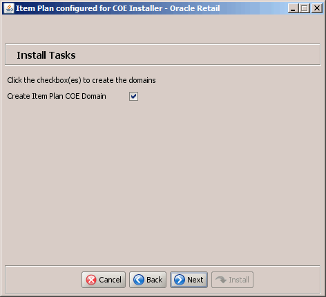

The Install Tasks Window opens.
Select or clear the Create Item Plan COE Domain option:
To create the IP COE domain, select the Create Item Plan COE Domain option, which is selected by default.
Note: Domain builds use the environment specified in theretaillogin.ksh environment setup script. If you change any environment details, edit the retaillogin.ksh script and any subsequent scripts called by retaillogin.ksh.
For more information about the |
To support the IP COE domain, but not create the actual domain, clear this check box.

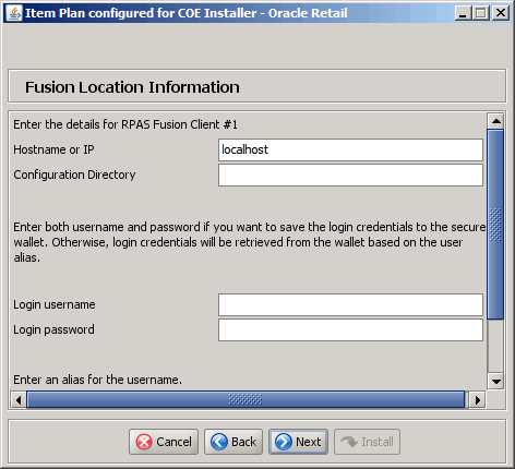

The Fusion Location Information Window opens.
Note: The Fusion Location Information windows open when you select the RPAS Fusion Client configuration check box on the Choose Components to Install Window.If you are not installing the RPAS Fusion Client configuration, proceed to step 9. |
Enter the relevant information in the following fields:
| Field | Description |
| Enter the number of RPAS Fusion Client servers to install these configurations on: (1-4) | Enter the number of servers running the RPAS Fusion Client where you want to install the IP COE configuration. In case the RPAS Fusion Client is running on a single server, enter 1. If you have a clustered installation, you can enter up to four servers |
| Enter the RPAS server hostname: | Enter the hostname of the RPAS server. |
| Enter the RPAS server port: | Enter the port number of the RPAS server. |
| RPAS Solution Path | Enter the location of the RPAS domain for IP COE. |
Based on the number of servers you entered, the Fusion Location Information (Details) Window opens.
Enter the server details in the following set of fields for each configuration:
| Hostname or IP | Enter the host name or IP address of the server where the RPAS Fusion Client is installed. |
| Configuration Directory | Enter the location of the config directory available at the location where the RPAS Fusion Client is installed. |
| Login username | Enter the user name to log on to the server where the RPAS Fusion Client is installed. |
| Login password | Enter the password associated with the user name. |
| Login username alias | Specify an alias name for the administrative user. Specifying an alias name for the administrative user enhances the security for the application. When left blank, the alias name defaults to the administrative user name. |
Note: Information such as user credentials for the RPAS Fusion Client is encrypted and stored in a secure location in the application installation directory. This location is called the Oracle Wallet.When the installation starts, the administrative user credentials are retrieved from the Oracle Wallet based on the alias name specified in this window. |
