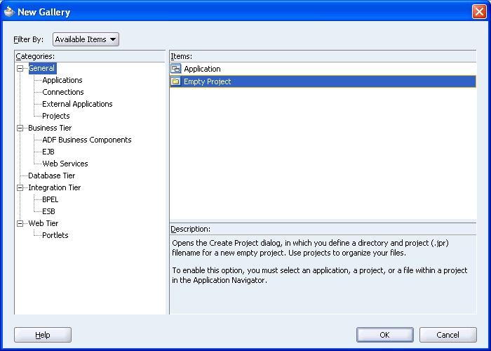

In Oracle JDeveloper, go to the Applications Navigator. Under Applications, right-click SRDemoSample_Starter and select New. The New Gallery dialog box is displayed.
Under Items, select Empty Project, as shown in Figure 4-1 and click OK. The Create Project dialog box is displayed.

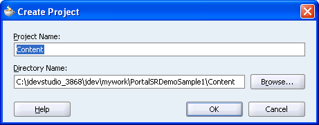

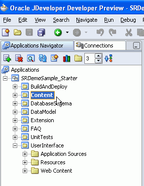

Enter Content in the Project Name field, as shown in Figure 4-2 and click OK. The Content project displays in the Applications Navigator, as shown in Figure 4-3.
Figure 4-3 Applications Navigator - Content Project

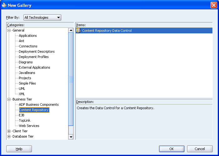

Under the Applications Navigator, right-click Content and select New. The New Gallery dialog box is displayed.
Under Categories, expand the Business Tier node and select Content Repository. Then, under Items select Content Repository Data Control as shown in Figure 4-4, and click OK. The Create Data Control dialog box is displayed.
Figure 4-4 The New Gallery Dialog Box - Content Repository Data Control

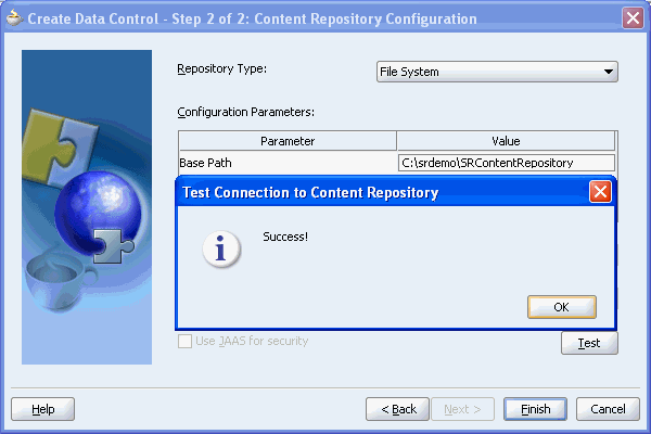

On step 2, select File System from the Repository Type box.
In the Base Path field, enter the path to the folder in which your content is placed, that is, C:\srdemo\SRContentRepository.
Click the Test button to check the connection. You should see the Success! message, as shown in Figure 4-5.
Figure 4-5 Test Connection to the SRContentRepository
Click OK to close the message box, and then click Finish.

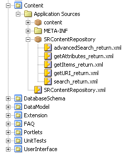

Your Applications Navigator should show new entries under Content\Application Sources, as shown in Figure 4-6.
Figure 4-6 Files for the New Data Control

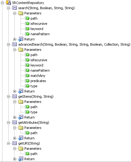

To display the methods of the SRContentRepository data control, select Data Control Palette from the View menu.
Under SRContentRepository, you should see a hierarchical list of methods, parameters, and operators for the new data control, as shown in Figure 4-7.
Figure 4-7 Data Control Palette - SRContentRepository
