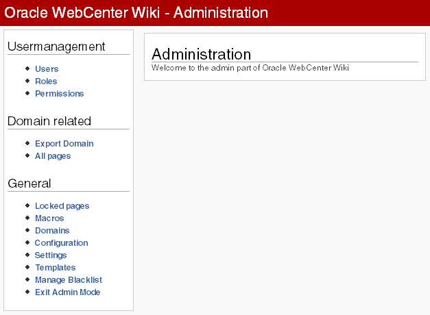

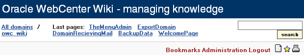

For more information on administrating wiki and other related topics, refer tohttp://yawiki.jzonic.org/page/show.jz?page=yawiki:TheIntroduction.To access the Oracle WebCenter Wiki Administration mode, first log in using the administrator user name and password you created during the installation of Oracle WebCenter Wiki. In the upper right menu of each wiki page, you can click the Administration link to access the Administration mode. Figure E-1 shows this link.

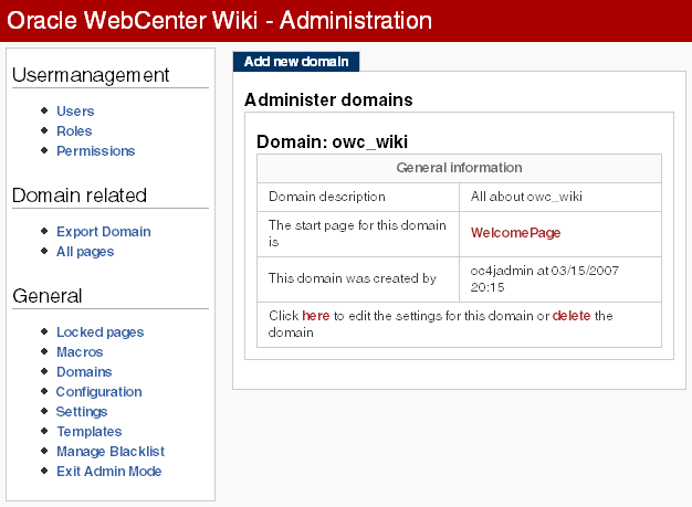

Once you click this link, you see the Administration mode, as shown in Figure E-2.
To exit the Administration mode, click Exit Admin Mode under General.
The wiki administrator organizes the wiki pages into domains, then can create menus to enable easy access to pages within each domain. This section discusses basic domain and menu administration tasks.
As a wiki administrator, you create, edit, or delete the domains that will contain the pages the wiki users then create, edit, or delete. In Oracle WebCenter Wiki, a domain is the highest level of categorization and all wiki pages must belong to a domain.To create a new domain, in the Administration mode, under General, click Domains.
Figure E-3 Administration Page of the Wiki

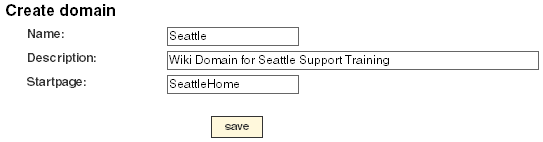

To create a new domain as shown in Figure E-3, click Add a new domain. Enter a domain name, a description, and a name for your new start page, then click Save, as shown in Figure E-4.

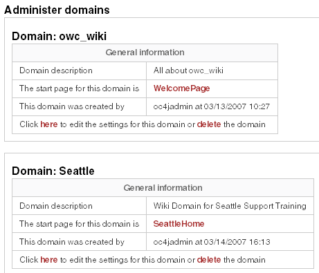

When naming your page, ensure you adhere to the wiki markup standards, as explained in Table 6-2 in Chapter 6, "Integrating Oracle WebCenter Wiki".The new domain displays on the Administer domains page as shown in Figure E-5.

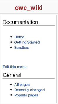

As an administrator, you can create a single menu for each domain, then modify them. The following is an example of how you can modify the existing menu in the domain.
First, in the menu, click the Edit this menu link, as shown in Figure E-6.

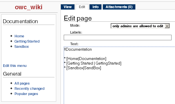

When you click the edit link, you can edit the menu the same way you edit a page, using the Edit page text box as shown in Figure E-7.
The menu consists of menu topics. The menu topics display as headers of every block of menu items. For example, in the owc_wiki domain in Oracle WebCenter Wiki, General is menu topic and All Pages is a menu item. The topics display in the order you create them. Within each topic, you can define menu items, which can be links to wiki pages or links to targets external to the wiki. When you create a menu item, you must specify a name and either a wiki page name or a URL. The name displays in the menu.

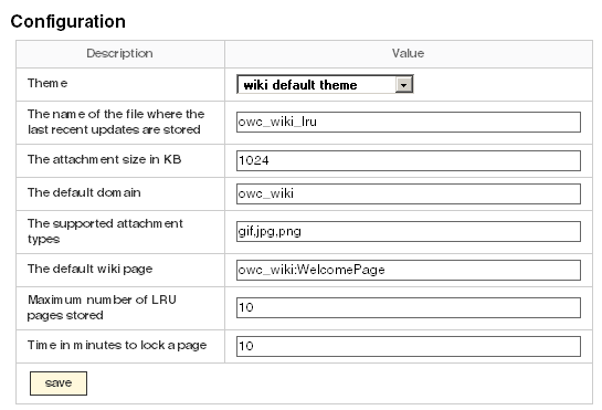

After you create a menu, it is good practice to change the mode to only administrators are allowed to edit (from the Mode drop-down list, select this option). Although wiki automatically removes the Edit this menu link from the menu if the registered user is not administrator, users may accidentally edit the menu page.As the administrator, you can configure the locking and unlocking of wiki pages. Every time a user edits a wiki page, the page is locked for a specified time period for that particular user before other users can modify that page. As the administrator, you can configure the time period during which only the current user can modify the page. To specify the time period (in minutes), click the Configuration link under General in the administration menu, then enter a time in the Time in minutes to lock a page field. Figure E-8 shows this page.

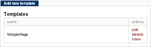

Templates enable you to set up a framework for users when they create pages. You can create new user interface templates as well as edit or delete existing ones. To access the templates, in the Administration mode, under General, click Templates. Use the links next to an existing template name to modify it. Or, click Add new template to create a new template (Figure E-10).When you name, edit, and create a template, use the wiki markup language described in Section 6.3.3, "Wiki Markup". Template names should follow the same convention as page names.

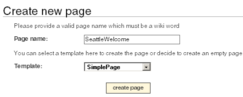

After you create a new template, users can choose to use this new template when creating a page (Figure E-11).
Figure E-11 Creating a New Page with a Template
You can apply themes to change the look and feel of your wiki. To change the theme, in the Administration mode, under General, click Configuration. Choose a different theme from the Theme drop-down list.

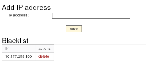

You can block Edit access to the wiki from a certain IP address. To do so, under General, click Manage Blacklist (Figure E-13). Enter the IP address you wish to block, then click Save. The IP address you have blocked displays in the Blacklist.

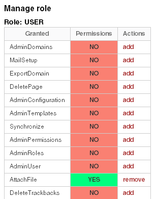

You can set permissions for the two roles user and admin for the wiki operations from the Administration mode. In the navigation bar, under User Management, click Roles. Under the role you want to modify, click edit. For example, under the USER role, click edit to view the page in Figure E-14.

In the Administration mode, you can configure the following options:
The name of the file where the last recent updates are stored
The default attachment size in kilobytes (KB)
The default domain
The supported attachment types
The default wiki page
The maximum number of LRU pages stored
You can find these options and others by choosing Configuration under General, as shown in Figure E-16.
