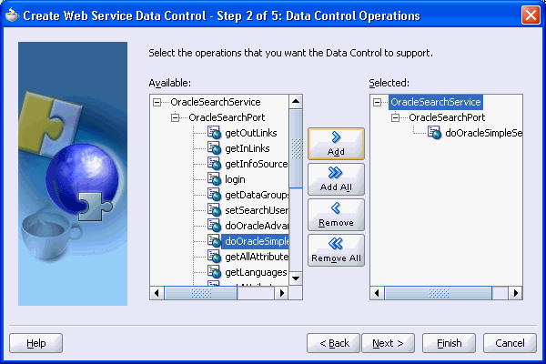

From the Data Control Operations page, you choose which methods you want to expose by moving them from the Available list to the Selected list. For the purposes of this example, move doOracleSimpleSearch to the Selected list. When you are done, the page should look similar to Figure 8-2.

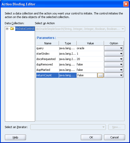

Select Tables, ADF Read-only Table from the context menu that appears. The Action Binding Editor appears.
For the sake of simplicity, you can hard code the values for each parameter as shown in Table 8-1.
When you are done, the dialog should look like Figure 8-4. Click OK.

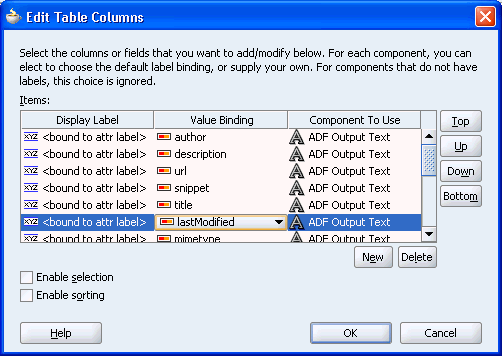

The Edit Table Columns dialog appears. Select lastModified and click Delete (Figure 8-5).

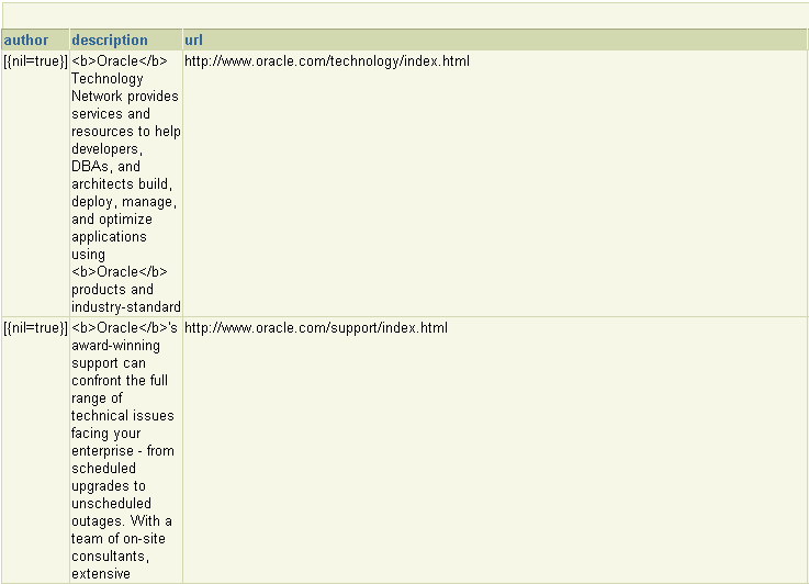

Browse through your output and notice how occurrences of the word oracle are surrounded by <b></b> tags. Figure 8-6 shows a small sample fragment of this output. Currently, the search hits are not formatted because you have not yet converted the view component that renders this column to OutputFormatted.

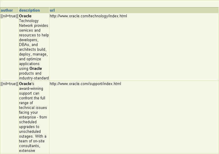

Run the page again to see the changes. You should now see output similar to that in Figure 8-7. Notice how the <b></b> around the word oracle is now interpreted so that search hits appear in bold.
