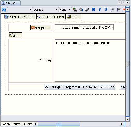

Open edit.jsp in the visual designer and click the Design tab. Notice that the JSP consists of a form field, a form input field, and two form button fields, as shown in Figure 19-2.
Add the code that is indicated in bold in the following code excerpt to implement a form field called Content:

Click the Design tab. Your page should now look similar to Figure 19-3.
Figure 19-3 Modified edit.jsp in the Design View

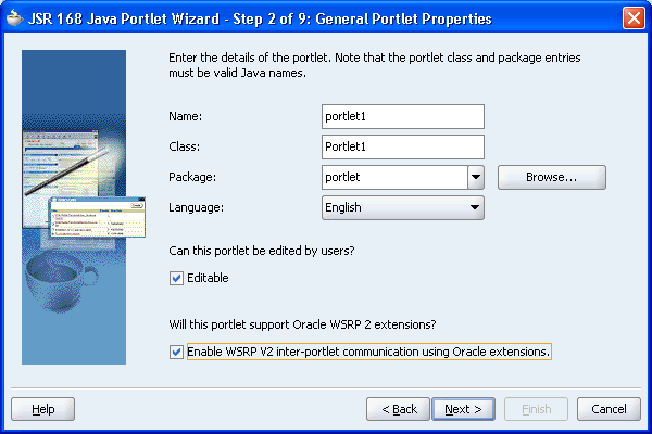

When you reach the General Properties page of the wizard, be sure to select the Enable WSRP V2 inter-portlet communication using Oracle extensions check box as shown in Figure 19-4.
Figure 19-4 General Portlet Properties Page in Portlet Wizard

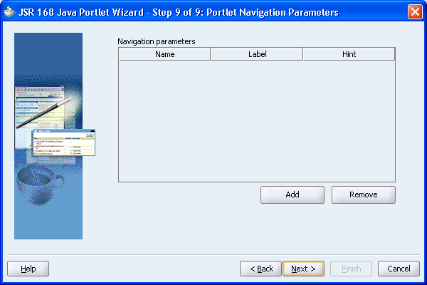

Proceed through the wizard as you normally would until you reach the Portlet Navigation Parameters page. See Section 18.5, "Building JPS-Compliant Portlets with Oracle JDeveloper" for basic information about going through the wizard.
When you reach the Portlet Navigation Parameters page (Figure 19-5), click the Add button. A new row is added to the Navigation parameters table.
Figure 19-5 Portlet Navigation Parameters Page of Portlet Wizard

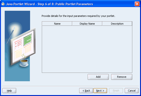

To add parameters to your portlet, perform the following tasks:
Right-click your project and choose New from the context menu.
From New Galleries, choose the Portlets category and then the Oracle PDK Java Portlet item.
Proceed through the wizard as you normally would until you reach the Public Portlet Parameters page. See Section 18.7, "Building PDK-Java Portlets with Oracle JDeveloper" for basic information about going through the wizard.
When you reach the Public Portlet Parameters page, as shown in Figure 19-6, click the Add button. A new row is added to the table.
Figure 19-6 Public Portlet Parameters Page of Portlet Wizard
Click the default name that appears in the Name column. Use the Backspace key to delete the default name.
Enter a new parameter name, for example, Parameter_01.
Repeat steps 6 and 7 for the Display Name and Description columns.
Repeat steps 4 through 7 for each public parameter that you want to add to the portlet.
Click Finish.

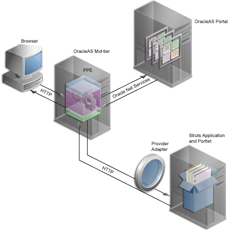

Oracle Struts Portlet
To create a portlet using the Struts framework, or to generate a portlet from an existing Struts application, you must deploy all the components in the J2EE container. In the context of OracleAS Portal, the Struts application is called by the PPE, and not by the browser as compared to a standalone Struts application. When a portlet show call is made, the page engine sends a request to the Struts portlet renderer, which then forwards the request to the Apache Struts Controller servlet, as shown in Figure 19-8.
Figure 19-8 Integrating Struts Applications with OracleAS Portal

Now that your portlet is ready to be used by consumers, you must make it accessible by registering it. For information about how to register your PDK-Java portlet, see Section 18.10, "Registering and Viewing Your Portlet".
Oracle Application Server enables you to easily create Struts portlets using Oracle JDeveloper and publish existing Struts application portlets. For more information about using the Oracle JDeveloper Java Portlet wizards, see Chapter 18, "Creating Java Portlets".
