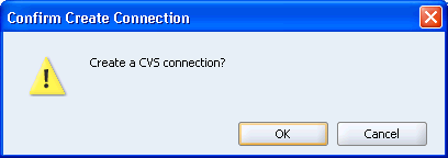

If the Confirm Create Connection dialog box (Figure 11-1) appears, then click OK.
Figure 11-1 Confirm Create Connection Dialog Box

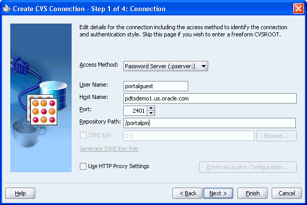

On the Connection page (Figure 11-2), enter your connection information for CVS.
Figure 11-2 Connection Page of Create CVS Connection Wizard

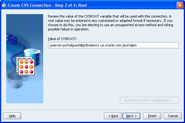

On the Root page (Figure 11-3), enter the Value of CVSROOT.
Figure 11-3 Root Page of Create CVS Connection Wizard

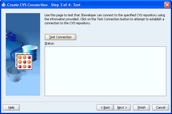

On the Test page (Figure 11-4), click Test Connection. The Log In to CVS dialog box is displayed, as shown in Figure 11-5.
Figure 11-4 Test Page of Create CVS Connection Wizard

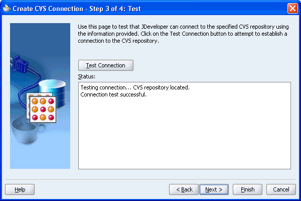

If the test is successful, then you should see something similar to Figure 11-6.
Figure 11-6 Successful Test Page of Create CVS Connection Wizard

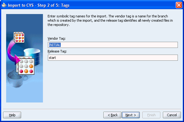

The Tags page specifies the tag names for the creation of the project. Leave the default values unchanged for the purposes of this example, as shown in Figure 11-9.
Figure 11-9 Tags Page of Import to CVS Wizard

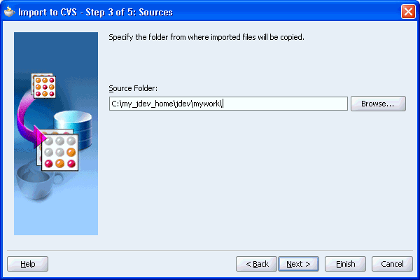

The Sources page specifies the location of the application. Leave the default value unchanged for the purposes of this example, as shown in Figure 11-10.
Figure 11-10 Sources Page of the Import to CVS Wizard

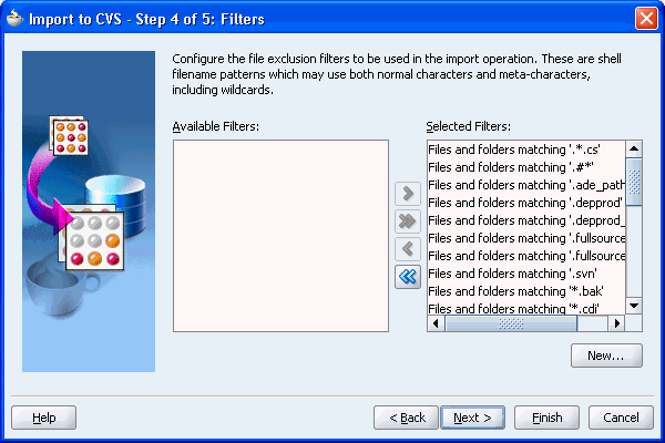

The Filters page specifies filters to exclude files from the import operation. Leave the default filters unchanged for the purposes of this example, as shown in Figure 11-11.
Figure 11-11 Filters Page of Import to CVS Wizard

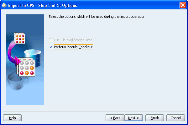

The Options page lets you specify whether you want to immediately check out the newly created module and begin versioning your project. Leave the default choice unchanged for the purposes of this example, as shown in Figure 11-12.
Figure 11-12 Options Page of Import to CVS Wizard
