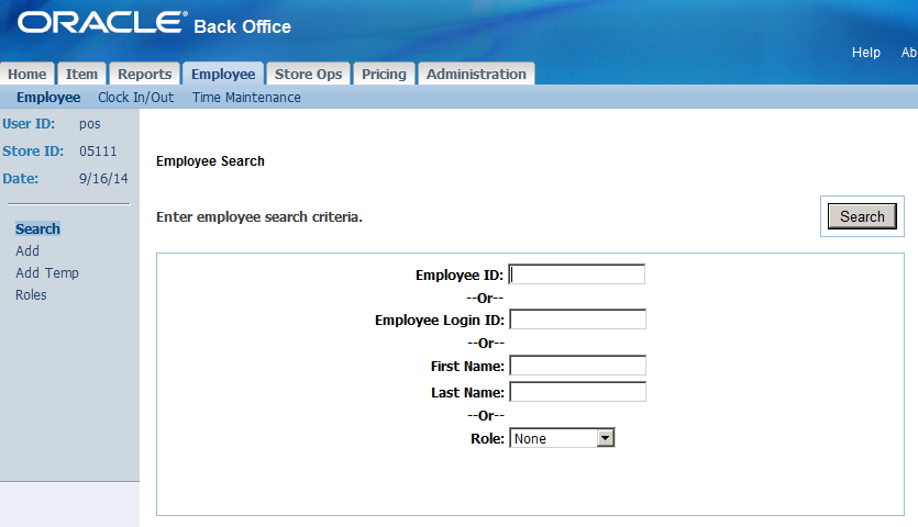

The existing employee search page allows the operator to search for employees by their employee ID, or by first and last name, or by role. This example will add the ability to search for employees by their login ID.

The user interface changes require that you update the JSP page to add the additional search criteria. You also need to ensure any strings you use are properly externalized for future localization. Depending on what kind of form is used you may have additional work to perform. A review of the Struts action mapping used for employee searches will reveal what changes are required to any action form in use. Finally, the action used to search will also need to be modified.
Modification of the JSP file is fairly straightforward. Taking the existing JSP structure into consideration, insert the new search criteria between the Employee ID field and the First and Last Name fields.
Adding the search criteria requires that you insert the appropriate HTML and JSP tags to the <source_directory>\webapp\employee-webapp\web\employee\employeeSearch.jsp file. You can identify where the changes need to be placed by looking for the message tag that displays the employee.employeeForm.employeeFirstName.label message. The code in the following example presents the required changes to the employee search page.
Example 8-3 EmployeeSearch.jsp Modifications
<tr> <td align="right" class="fieldname">--<bean:message key="prompt.or"/>--</td> <td align="right"> </td> </tr> <tr> <td align="right" class="fieldname"><bean:message key="employee.employeeForm.employeeLoginId.label"/>: </td> <td align="left"> <html:text styleClass="data" property="searchEmployeeLoginId" size="20" maxlength="10" tabindex="2"/> </td> </tr> <tr> <td align="right" class="fieldname">--<bean:message key="prompt.or"/>--</td> <td align="right"> </td> </tr> <tr> <td align="right" class="fieldname"><bean:message key="employee.employeeForm.employeeFirstName.label"/>: </td> <td align="left"> <html:text styleClass="data" property="searchEmployeeFirstName" size="20" maxlength="16" tabindex="3"/></td> </tr>
The text in bold in this example is the new text that was added to the employeeSearch.jsp page. It introduces a new label and new text box to collect the new search criteria.
| Note:The tab index values were incremented for all of the remaining input fields. |
The modified screen is presented in Figure 8-3.
