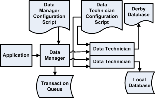

Figure 3-1 shows how Data Managers and Data Technicians handle communication with the database in the Point-of-Service application.
The Point-of-Service system uses the following components to write to the database:
The Data Manager's primary responsibilities are to provide an API to the application code and to contact the Data Technician and pass it data store requests.
There is one Data Manager per client. The Data Manager manages connections to multiple Data Technicians, for example, there is a Data Technician residing on the client that retrieves data from the offline (Derby) database, and there is also a Data Technician residing on the store server that manages access to the store database. The Data Manager on the client is configured to determine which Data Technician provides which data service.
The Data Manager Configuration Script is an XML file that specifies the properties of the Data Manager.
The Data Technician handles the database connection. Configure the Data Technician with an XML script. The Data Transaction class is the valet from the manager to the technician. The Data Transaction class has the add, find, and update methods to the database. Typically, there is one Data Technician that communicates with the local database and one that communicates with offline database.
| Note:Most managers create valets when they need talk to technicians. Data Manager works a little differently: the Data Transaction class calls the Data Manager and passes itself as a valet. The valet finds the data operation class, then the valet knows which technician it is associated with and calls its execute method. |
The Data Technician configuration script is an XML file that specifies the properties of the Data Technician.
The Transaction Queue collects data transactions and guarantees delivery.
Offline Database is the Derby database that is used when the register is offline.
The Local Database is the store database.

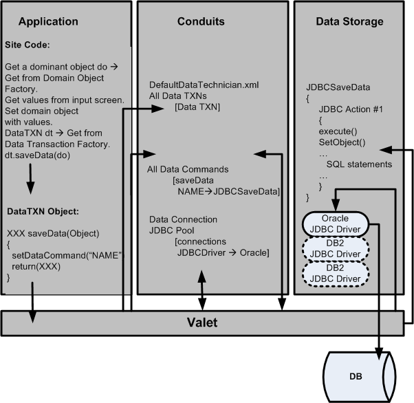

At runtime, the tour code requests a data transaction object from the Data Transaction Factory.
The Data Transaction Factory verifies that the transaction is defined in POSDataManager.xml and the transaction object is returned to the tour code.
The tour code calls a method on the transaction object that creates a vector of data actions. A data action corresponds to a set of SQL commands that are executed as a unit. (Data actions are reused by different transactions.)
The method in the transaction object gets a handle to the Data Manager and calls execute(), sending itself as a parameter. This instructs the Data Manager to send the Transaction object (a valet) across the network to the Data Technician.
| Note:Most Manager/Technician pairs work differently. The standard pattern is for the tour code to get a handle to the Manager, then call a method on the manager that creates the valet object and sends it to the technician. For the Data Manager/Technician pair, the transaction object (the valet class), gets the handle to the Data Manager. The tour code is only responsible for getting a transaction object from the factory and calling the appropriate method. |
On the server side, the Data Technician configuration script, DefaultDataTechnician.xml, lists all available transactions. It also defines an operation class for each data action. Each data action is then processed by the appropriate data operation class.

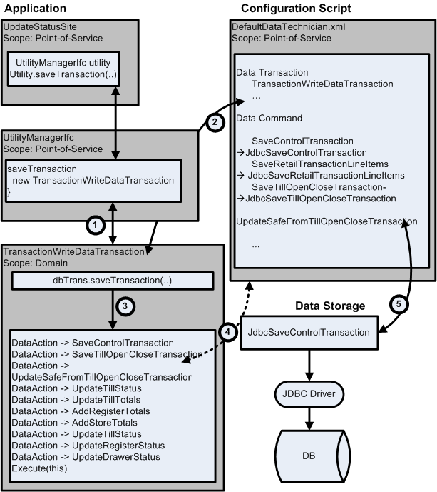

The Data Manager and Data Technician work together to provide access to the database from the application. The developer rarely modifies these. Typically, the site code and JDBC code are updated. To identify which JDBC class should be used, trace through the site code until the DataAction sets the operation name.
The following descriptions explain the labels in the figure.
UpdateStatusSite uses the Utility Manager to call the saveTransaction() method as shown in Example 3-4. The utility.saveTransaction() method uses the data transaction class TransactionWriteDataTransaction to save the till transaction.
The following code samples show details for the previous figure.
Example 3-5 UtilityManager.java: Save Data Transaction
TransactionWriteDataTransaction dbTrans = new TransactionWriteDataTransaction(tranName); dbTrans.saveTransaction(trans, totals, till, register);
Example 3-6 TransactionWriteDataTransaction.java: Save Transaction
public void saveTransaction(TransactionIfc transaction,
                                FinancialTotalsIfc   totals,
                                TillIfc              till,
                                RegisterIfc          register)
                                throws DataException
  int transactionType = transaction.getTransactionType();
  switch(transactionType)
  {                           // begin add actions based on type
case TransactionIfc.TYPE_OPEN_TILL:
                    addSaveTillOpenTransactionActions(transaction);
                    break;
                case TransactionIfc.TYPE_CLOSE_TILL:
                    addSaveTillCloseTransactionActions(transaction);
                    break;
The <source_directory>\applications\pos\deploy\server\config\technician\DefaultDataTechnician.xml file is the configuration file for the Data Technician and is used to configure the links between the application and the JDBC class that performs the work. All Data Transaction classes must be defined in this file, including TransactionWriteDataTransaction.
The TransactionWriteDataTransaction class instantiates the DataAction object and sets the data operation name to UpdateTillStatus and so on. Other data actions occurred before these till data actions. Data Actions are added in the specific order in which they should occur.

The DefaultDataTechnician uses the data command to list several data operation names. The data operation name UpdateTillStatus points to the name of the JDBC class, which is JdbcUpdateTillStatus.
Example 3-10 DefaultDataTechnician.xml: Define Data Operation Class
<DATATECHNICIAN
  package="oracle.retail.stores.domain.arts">
  <TRANSACTION name="TransactionWriteDataTransaction" command="jdbccommand"/>
  <COMMAND name="jdbccommand"
           class="DataCommand"
           package="oracle.retail.stores.foundation.manager.data"
  <COMMENT>
    This command contains all operations supported on a JDBC
  </COMMENT>
  <POOLREF pool="jdbcpool"/>
  <OPERATION class="JdbcUpdateTillStatus"
    name="UpdateTillStatus">
    <COMMENT>
      This operation updates the till status in the database.
    </COMMENT>
  </OPERATION>
</DATATECHNICIAN>
The JdbcUpdateTillStatus class is used to update the till status to the database table. See the next section.
Use this procedure to modify the data operation class to access the database.
Add a save method to the data operation class.
Write an implementation for methods written for the data operation class.
Second, the credit data must be saved to the new database table using SQL factory methods.

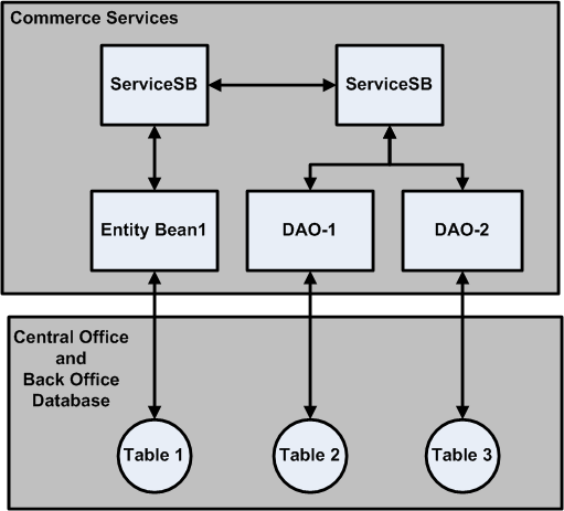

Point-of-Service uses an ARTS-compliant database. Data is stored and retrieved by entity beans in a bean-managed persistence pattern, so the system makes database calls from the entity bean code.
A single entity bean exists for each database table, and handles reads and writes for that table. Each entity bean contains the necessary methods to create, load, store, and remove its object type.
The Central Office application writes data to the enterprise database, which serves as a repository for information about transactions across the whole enterprise.
The Back Office application writes data to the Store database, a repository for transaction information for a single store.
A data access object (DAO) provides an abstract interface to the underlying database tables. It accesses one or more tables that belong to the same logical unit to read and write information to the database.
Table 3-2 lists related sources that provide specific information about the database for your use when developing code.
Table 3-2 Related Documentation
| Source | Description |
| ARTS Database Standard | See  |
| Data Dictionary | Contains table and column definitions for the database used to store Point-of-Service data. See the docs zip file provided with your Point-of-Service documentation. |
| Database Diagrams | Diagrams which show the relationships between various tables in the database schema. See the docs zip file provided with your Point-of-Service documentation. |
As described in Chapter 2, "Oracle Retail POS Suite Technical Architecture" a persistence layer of entity beans represents the database tables to the rest of the system. One bean represents each table.
Figure 3-4 illustrates these relationships.
Each commerce service communicates with one or more entity beans or DAOs, and each entity bean communicates with one database table. A DAO typically communicates with one or more tables that belong to the same logical grouping. Although there are exceptions, in general only one commerce service communicates with an entity bean; other services request the information from the relevant service rather than talking directly to the entity bean. For example, if the Customer Service needs information provided by the Item Bean, it makes a request to the Item Service.
