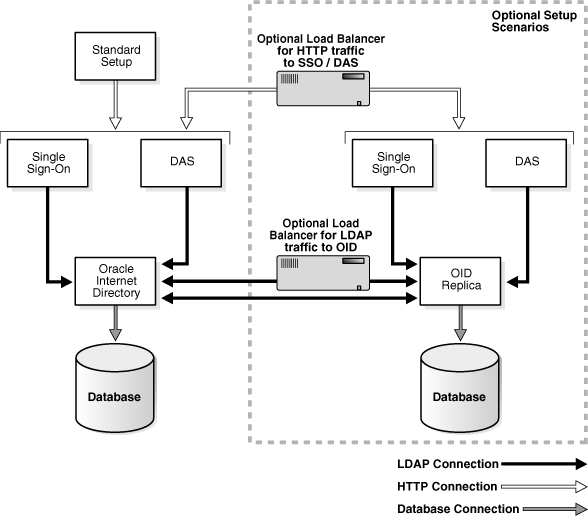

As shown in Figure 12-1, a variety of components and communication paths may be configured for SSL. The following lists references to the instructions for each:
Communication between the Oracle Internet Directory Replication server and the Oracle Internet Directory server: Oracle Application Server High Availability Guide, section titled "Secure Sockets Layer (SSL) and Oracle Internet Directory Replication"
Communication between Oracle Directory Integration and Provisioning and the Oracle Internet Directory server: Oracle Identity Management Integration Guide, chapter titled "Oracle Directory Integration and Provisioning Server Administration"

Figure 12-1 Oracle Identity Management Components and SSL Connection Paths

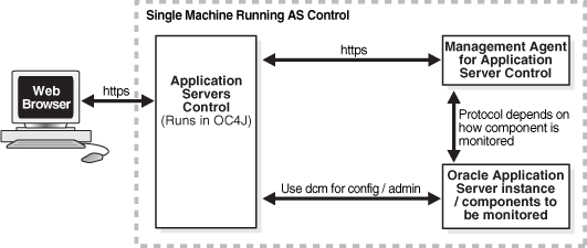

Oracle Enterprise Manager 10g comprises two components, each of which can be configured for SSL communication: Grid Control Console and Application Server Control.
Follow the steps in the "Configuring Security (SSL and HTTPS) for Grid Control" in the Oracle Enterprise Manager Advanced Configuration Guide.
The communication paths of interest in the SSL configuration of Application Server Control are shown in Figure 12-2, and are labeled https.
Figure 12-2 SSL Connection Paths in Oracle Enterprise Manager 10g
To secure the communications between the Web browser and Application Server Control, and between Application Server Control and the Oracle Application Server components, refer to Section A.3.
