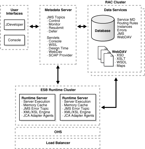

To configure Oracle Enterprise Service Bus for high availability, you configure it as a cluster. An ESB cluster is a collection of instances with identical configuration and deployment. Clusters enforce homogeneity between member instances so that a group of ESB systems can appear and function as a single instance. With appropriate front-end load balancing, any instance in an ESB cluster can serve requests. This simplifies configuration and deployment across multiple instances and enables fault tolerance among clustered instances.
When you set up Oracle Enterprise Service Bus as a cluster, you first need to install the J2EE Server and Web Server option of the Application Server Advanced Installation on all the computers that belong to the cluster. Next, you need to install the Design Time (repository) OracleAS Middle Tier option of the ESB installation on one computer of the ESB cluster. Then install the Runtime OracleAS Middle Tier option of the ESB installation on the remaining computers of the ESB cluster. You can have multiple runtime installations, but only one design time (repository) installation. After the installations are completed, you need to configure the systems in the ESB cluster.
For an illustration of an ESB architecture showing a clustered environment, see Figure 9-1.
Figure 9-1 ESB Architecture - Clustered Environment
Description of Figure 9-1 follows
Description of "Figure 9-1 ESB Architecture - Clustered Environment"
By configuring ESB systems into ESB clusters, you can take advantage of the high availability and load balancing features that OC4J instances configured with multiple processes provide. Configuring ESB systems in ESB clusters do not limit the flow of messages; messages can flow across ESB clusters.
When you install Oracle Enterprise Service Bus, an ESB cluster named ESB is created and configured for you. This default ESB cluster is provided so that you can use ESB tutorial documented in the Oracle Enterprise Service Bus Quick Start Guide without the prerequisite of configuring an ESB cluster manually. For production systems, you will want to create and configure additional ESB clusters, if you want to take advantage of the load-balancing and high-availability features enabled by OC4J clusters.
For information about high availability solutions for Oracle Enterprise Service Bus, see "High Availability for Oracle SOA Suite" in Oracle Application Server High Availability Guide. For information about high availability deployment scenarios for Oracle Enterprise Service Bus, see Oracle Application Server Enterprise Deployment Guide.

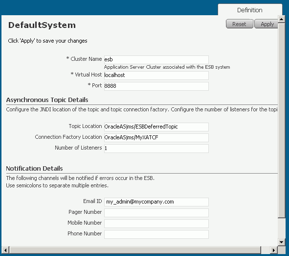

To specify the notification channels:
  1. Start the ESB Server and open the Oracle ESB Control.
    See "Opening the Oracle ESB Control" for instructions.
  2. In the Services navigation tree, select the ESB system for which you want to set channels under Notification Details.
    The Definition tab appears similar to Figure 9-2.
    Figure 9-2 ESB System – Definition Tab
    Description of Figure 9-2 follows
    Description of "Figure 9-2 ESB System – Definition Tab"
  3. Enter or update the values in the Email ID, Pager Number, Mobile Number, or Phone Number fields. Separate multiple entries with commas.
    For example, enter sys_admin@mycompany.com,it_mgr@mycompany.com in the Email ID field.
  4. If you are satisfied with your changes, click Apply; otherwise, click Reset to return the properties to the settings that were presented when you opened the page.

Configuring Paging Notification
To send paging notifications, make sure that paging for the Oracle Enterprise Service Bus has been set up properly for each account in the Oracle_Home\integration\esb\config\ns_iaswconfig.xml file.
See "Configuring the Wireless Provider for Voice".
Configuring Mobile Notification
To send mobile notifications, make sure that mobile notification for the Oracle Enterprise Service Bus has been set up properly for each account in the Oracle_Home\integration\esb\config\ns_iaswconfig.xml file.
Configuring Phone Notification
To send phone notifications, make sure that the phone notification for the Oracle Enterprise Service Bus has been set up properly for each account in the Oracle_Home\integration\esb\config\ns_iaswconfig.xml file.

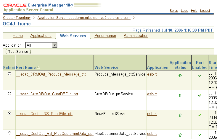

  4. In Application Server page, click the Web Services link.
    The list of Web services displays.
    Figure 9-3 Oracle Enterprise Manager Web Services
    Description of Figure 9-3 follows
    Description of "Figure 9-3 Oracle Enterprise Manager Web Services "

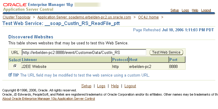

  5. Select a Web service and click the Test Service button.
    The Test Web Service page displays.
    Figure 9-4 Oracle Enterprise Manager Test Web Service
    Description of Figure 9-4 follows
    Description of "Figure 9-4 Oracle Enterprise Manager Test Web Service"

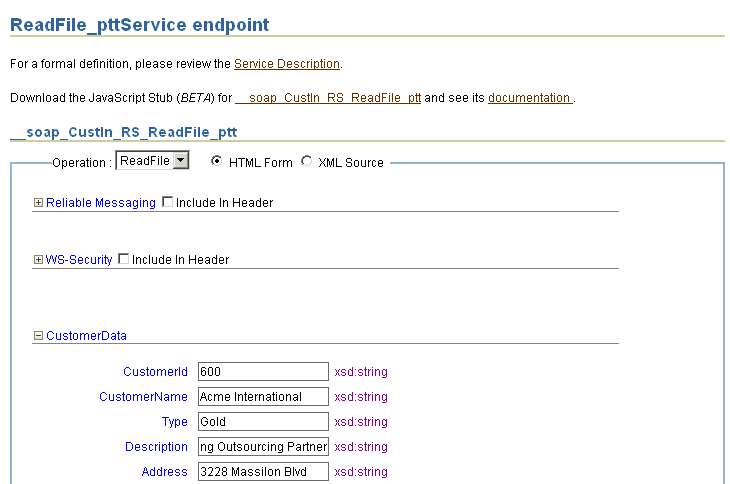

  7. Enter data in the fields of the Test page to test the service.
    For example, enter sample data for a customer order that would be processed by the CustIn_RS routing service.
    Figure 9-5 Oracle Enterprise Manager Test Page
    Description of Figure 9-5 follows
    Description of "Figure 9-5 Oracle Enterprise Manager Test Page"
  8. After providing sample data, click Invoke to display the Test Results page.

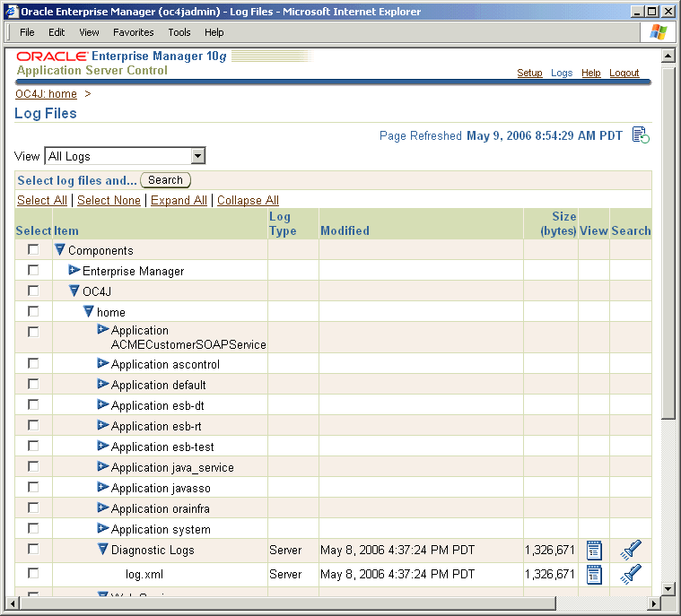

  4. Click Logs in the upper right corner to display the Log Files page.
  5. Expand Components > OC4J > name-of-application server
    The page appears similar to Figure 9-6.
    Figure 9-6 Oracle Application Server Control – OC4J Log Files
    Description of Figure 9-6 follows
    Description of "Figure 9-6 Oracle Application Server Control – OC4J Log Files"
  6. Expand the items in the Select list until you locate a specific log file, then click View.
    For example, expand the Application esb-dt, Application esb-rt, and Diagnostic Logs items. Click the icon in the View column to display the log file text.
    The diagnostic file is located in the log.xml file and can be viewed with a text editor.

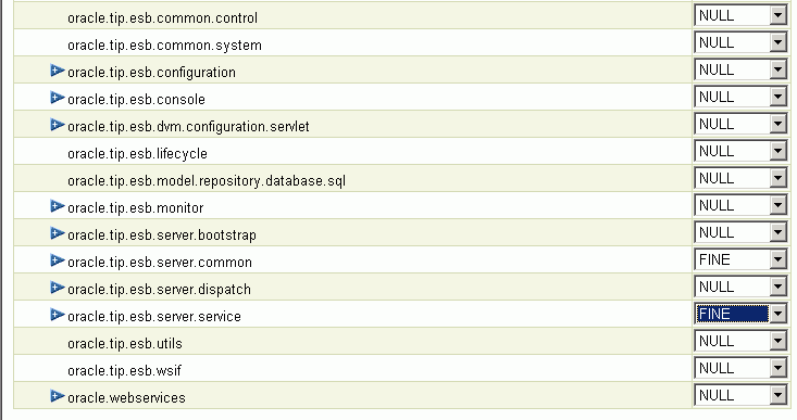

  6. Expand Root Logger > oracle to display the logger classes and the Log Level settings.
  7. You can locate specific logger classes by name with the search option. In the Search by Logger Name field, enter a string and then click Go.
    For example, enter esb in the Search by Logger Name field.
  8. In the Log Level list, select a level option for the logger classes you want to configure.
    For example, set oracle.tip.esb.server.common and oracle.tip.esb.server.service to FINE, as shown in Figure 9-6.
    Figure 9-7 Oracle Application Server Control – Logger Configuration
    Description of Figure 9-7 follows
    Description of "Figure 9-7 Oracle Application Server Control – Logger Configuration"
  9. Click Apply.
