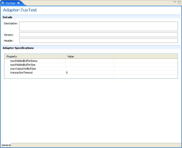

Adapter Metadata General Properties
You can enter and edit information about the adapter, such as the adapter name and the way in which you connect to the adapter. You make these changes in the Design perspective, Metadata view. The following describes how to open the Adapter General Properties editor.
  1. In Oracle Studio Design perspective, Metadata view, expand the Adapters folder.
  2. Right-click the Tuxedo adapter that you want to edit, and select Open.
    The General properties editor is displayed.
The Adapter General Properties editor is shown in the following figure:
Figure A-1 Adapter Metadata General Properties
The adapter metadata general properties
Description of "Figure A-1 Adapter Metadata General Properties"
If you are using the Tuxedo Gateway adapter, only the following Adapter specification properties are displayed:
  • maxFieldedBufferItems
  • maxFieldedBufferSize
The following table lists the adapter general properties:
Table A-1 Adapter General Properties
Field Description
Description
Specifies an identifying description of the adapter.
Version
The schema version.
Header
A C header file to map between the data structure and the adapter.
Authentication mechanism
Specifies the authentication to access the adapter. The available mechanisms are:
kerbv5
none
basic password
Max request size
Specifies the maximum size in bytes for an XML request or reply. Larger messages are rejected with an error.
Max active connections
Specifies the maximum number of simultaneous connections for an adapter (per process).
Max idle timeout
Specifies the maximum time, in seconds, that an active connection can stay idle. After that time, the connection is closed.
Adapter Specifications
The Adapter specifications sections displays adapter-specific properties for an interaction. The properties are:
  • maxFieldedBufferItems: Sets a limit to the number of items that a fielded buffer may hold. The default value is 800.
  • maxFieldedBufferSize: Limits the total size of a message buffer of type FML. The default is set to 2 Kilobytes.
  • maxOutputXmlBufSize: Controls the size of memory allocated for output message buffers of type XML. The default is set to 8 Kilobytes.
    Note: This property is not displayed if you are using the Tuxedo Gateway adapter.
  • transactionTimeout: Controls the duration of a Tuxedo transaction (in seconds). If not set (or set to 0), the Tuxedo transaction will not be interrupted and will last until explicitly terminated. This is the default.

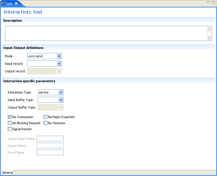

Adapter Metadata Interactions for the Tuxedo and Tuxedo Queue Adapters
This section describes the adapter metadata Interactions for the Tuxedo and Tuxedo Queue adapters.
The adapter metadata interactions editor for Tuxedo and Tuxedo Queue adapters is shown in the following figure:
Figure A-2 Adapter Metadata Interactions for Tuxedo and Tuxedo Queue
Description of "Figure A-2 Adapter Metadata Interactions for Tuxedo and Tuxedo Queue"
The following table lists the Interaction properties for the Tuxedo and Tuxedo Queue adapters:
Table A-2 Adapter Metadata Interaction Properties for Tuxedo and Tuxedo Queue
Field Description
Interaction name
Specifies the name of the interaction.
Description
Provides a descriptive identifier for the interaction.
Mode
Determines the interaction mode. The following interaction modes are available:
sync-send-receive: The interaction sends a request and expects to receive a response.
sync-send: The interaction sends a request and does not expect to receive a response.
sync-receive: The interaction expects to receive a response.
async-send: Not applicable.
Input record
Identifies an input record.
Output record
Identifies an output record for the results of an interaction.
Interaction Specific Parameters
Defines the properties and values of parameters specific to an interaction. The following properties are available:
Interaction Type: Select one of the following:
  • service: Enables service interaction (default).
  • enqueue: Stores a message on the queue that is specified by the information provided in the Queue Name box and the Queue Space Name box.
  • post: Posts an event, whose name is specified by the Event Name box, and any related data.
Input Buffer Type: The type of buffer used for the input.
Output Buffer Type: The type of buffer used for the results of an interaction.
No Transaction: Enables a service to be executed, regardless of the transaction context.
No Reply Expected: For future use.
No Blocking Request: Avoids a FROM request submission if a blocking condition exists.
No Timeouts: Ignores blocking timeouts.
Signal Restart: If selected, whenever a signal interrupts an underlying system call, this call is reissued.

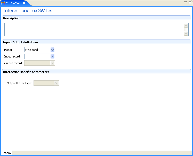

Adapter Metadata Interactions for the Tuxedo Gateway Adapter
This section describes the adapter metadata interactions for the Tuxedo Gateway adapter.
The adapter metadata properties editor for the Tuxedo Gateway adapter is shown in the following figure:
Figure A-3 Adapter Metadata Interactions for Tuxedo Gateway
Adapter metadata interactionsfor Tuxedo Gateway Adapters
Description of "Figure A-3 Adapter Metadata Interactions for Tuxedo Gateway"
The following table lists the adapter metadata interaction properties for the Tuxedo Gateway adapter:
Table A-3 Adapter Metadata Interaction Properties for Tuxedo Gateway
Field Description
Interaction name
Description
Mode
Input record
Output record

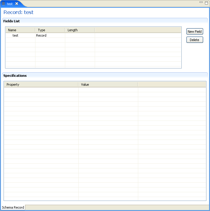

Adapter Metadata Schema Records
The Adapter Metadata Schema Records editor defines the general details of the input and output record structures for the interaction.The following describes how to open the Adapter Metadata Schema Records editor:
  2. Expand the Tuxedo adapter with the schema records that you want to edit.
  3. Expand the Schemas.
  4. Right-click the schema you want to edit and select Open.
    The Adapter Metadata Schema Records editor is displayed.
The Adapter Metadata Schema Records editor is shown in the following figure:
Figure A-4 Adapter Metadata Schema Records
Adapter Metadata Schema Records.
Description of "Figure A-4 Adapter Metadata Schema Records"
The following table shows the adapter metadata schema record properties.
Use the Fields List area to define single data items within a record.
Table A-4 Adapter Metadata Schema Record Properties
Field Description
Name
Specifies the name of the field.
Type
The data type of the field. The following are valid data types:
  • Binary
  • Boolean
  • Date
  • Double
  • Float
  • Int
  • Long
  • Numeric
  • Short
  • String
  • Time
  • Timestamp
  • XML
Length
The size of the field including a null terminator, when the data type supports null termination.
Use the Specifications box to specify field properties.
