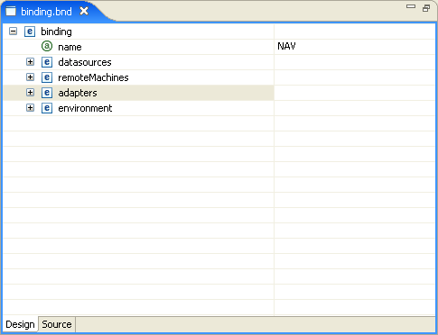

When you open an XML file, a graphical representation of the file is opened in the editor. The editor displays the elements and attributes in the file in the first column and their corresponding values in the second column. Each entry has an icon that indicates whether the entry is an element or an attribute. Click the Source tab to view the file in its native format. The following figure is an example of the editor's view of an XML file.

Do the following to edit an XML file in Oracle Studio
  1. In the Design perspective, open the Navigator view.
  2. In the Navigator view, find the item with the XML file that you want to edit. This can be a machine, binding, daemon, or user.
  3. Right-click the item and select Open as XML. A graphical list of the file's elements and attributes opens in the editor.
  4. Find the element or attribute (property) that you want to change.
  5. Click in the right column next to the property you are changing and edit or add the value.
  6. Save the file, then select it again in the Project Explorer and press F5 to refresh.
    The XML file is updated automatically.

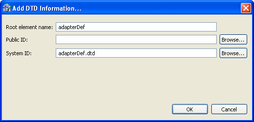

  1. Right-click an element or attribute and select Add DTD Information. The Add DTD Information dialog box opens.
    Figure F-2 Add DTD Information Dialog Box
    Add information to be defined in the DTD
    Description of "Figure F-2 Add DTD Information Dialog Box"
  2. Enter the information requested in the dialog box. The following table describes the Add DTD Information dialog box.

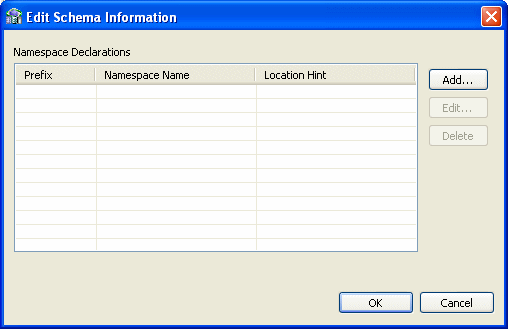

  1. Right-click an element or attribute and select Edit namespaces. The Edit Schema Information dialog box opens.
    Figure F-3 Edit Schema Information
    The dialog box with shema information
    Description of "Figure F-3 Edit Schema Information"
  2. Click on one of the buttons to make any changes to this information.
