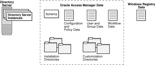

Figure 9-2 further illustrates the Oracle Access Manager deployment data that should be backed up, which includes the directory server instance.
Figure 9-2 Oracle Access Manager Data to Back Up
The directory server (or database) instance for an Oracle Access Manager deployment should be backed up. The information that is stored in the oblix tree of the directory server (or database) includes the Oracle Access Manager:
Schema (directory objects and attributes specific to Oracle Access Manager)
You can archive processed workflow instances and filter out transient data such as workflow tickets.
Again, you can either use directory or database vendor tools to extract policy and configuration data in the oblix tree or use Oracle Access Manager Configuration Manager to create a snapshot of the oblix tree.
