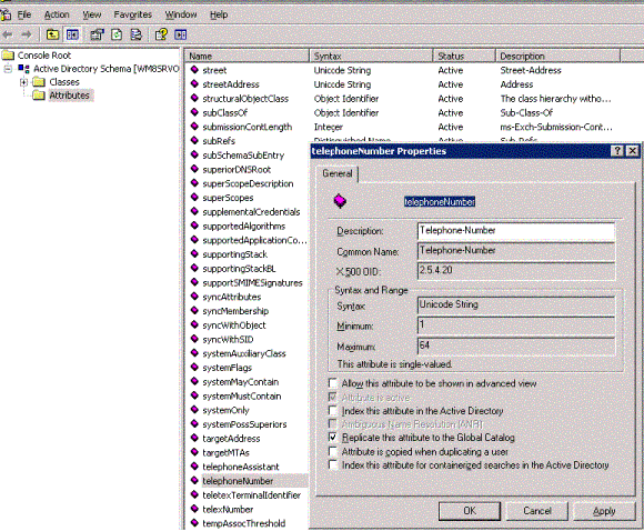

Open the Microsoft Active Directory schema.
Expand the Console Root folder, expand the schema, and then click Attributes.
Search for the field that you want to add, and then note down its name.
For example, if you want to add the Telephone Number field for reconciliation, then note down telephoneNumber. Figure 4-1 shows the Telephone Number field added in the telephoneNumber Properties dialog box.
Figure 4-1 New Field Added for Reconciliation

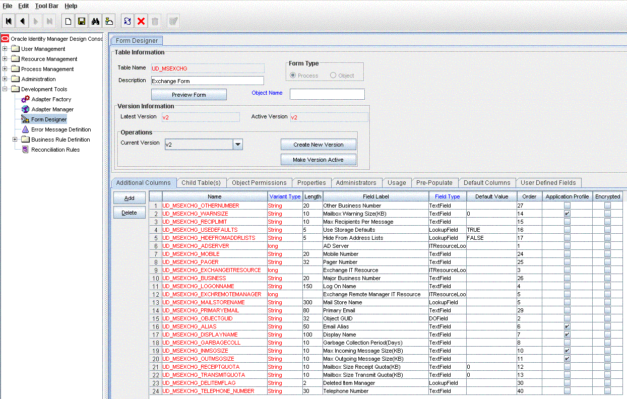

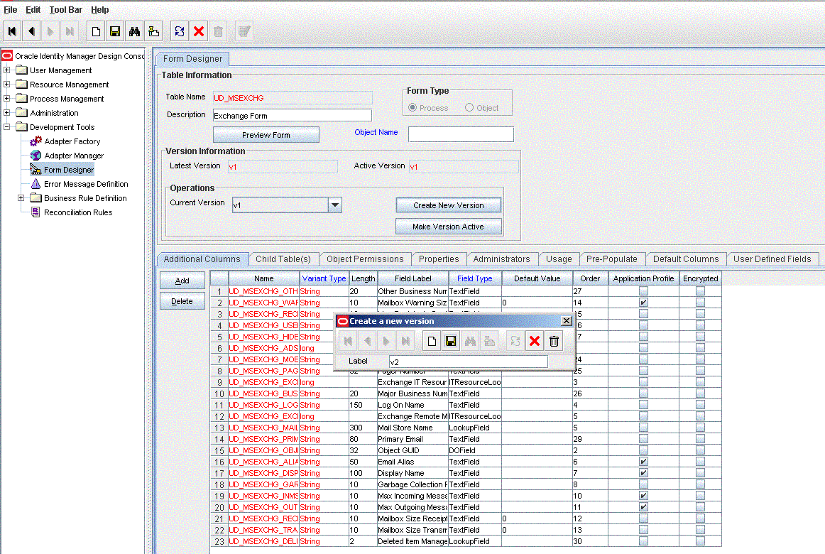

Search for and open the UD_MSEXCHG process form.
Click Create New Version. On the Create a new version dialog box, enter a new version in the Label field, and then click the Save icon. Figure 4-2 shows the new version of the form created in the process form.

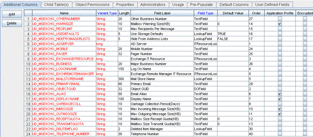

Click Add. A field is added to the list. Enter the details of the field.
For example, if you are adding the Telephone Number field, enter UD_MSEXCHG_TELEPHONE_NUMBER in the Name field and then enter the rest of the details of this field.
Click Save.
To activate the newly created form, click Make Version Active. Figure 4-3 shows details of the new field added in the process form.

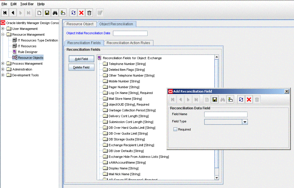

Add the new field to the list of reconciliation fields in the resource object as follows:
Expand Resource Management.
Double-click Resource Objects.
Search for and open the Exchange User resource object.
On the Object Reconciliation tab, click Add Field.
In the Add Reconciliation Field dialog box, enter the details of this field.
For example, enter Telephone Number in the Field Name field and select String from the Field Type list.
Later in this procedure, you will enter the field name as the Decode value of the entry that you create in the lookup definition for reconciliation.
Click Save. Figure 4-4 shows the new reconciliation field added to the resource object in the process form.
Figure 4-4 New Field Added to the Resource Object

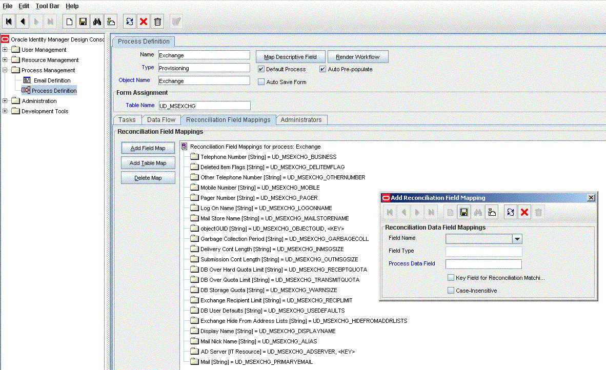

Create a reconciliation field mapping for the new field on the process form as follows:
Expand Process Management.
Double-click Process Definition.
From the Process Definition table, select and open the Exchange User resource object.
Click Reconciliation Field Mappings and then click Add Field Map.
In the Field Name field, select the value for the field that you want to add.
For example, select Telephone Number.
In the Field Type field, select the type of the field that is prepopulated.
Double-click the Process Data Field field. A list of process data columns is displayed. From the list, select the process data column corresponding to the process data field.
For example, select Telephone Number = UD_EXCHANGEUSER_TELEPHONE_NUMBER.
Click the Save icon. Figure 4-5 shows the mapping of new reconciliation field to the Process Data Field in the process form.

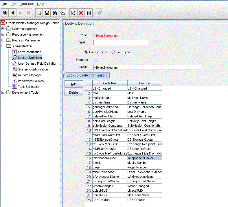

Create an entry for the field in the lookup definition for reconciliation as follows:
Expand Administration.
Double-click Lookup Definition.
Search for and open the AtMap.Exchange lookup definition.
Click Add and enter the Code Key and Decode values for the field. The Code Key value must be the name of the field on the target system, which you determined at the start of this procedure.
For example, enter telephoneNumber in the Code Key field and then enter Telephone Number in the Decode field.
Click Save. Figure 4-6 shows the code key and the decode value added to the lookup definition in the process form.
Figure 4-6 AtMap.Exchange Lookup Definition

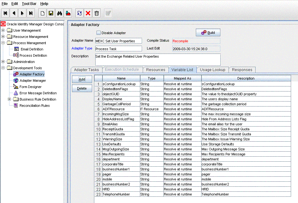

Create a new variable in the Adapter Factory section:
Expand Development Tools.
Click Adapter Factory and query to get all adapters. The adapter factory table is displayed.
Double-click MEXC Set User Properties.
Navigate to the Variable List tab, click Add, and create a new variable corresponding to the value that you want to provision.
Click Save. Figure 4-10 shows the new variable added in the process form.
Figure 4-10 New Variable Added in the Process Form

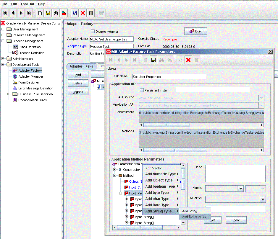

Add string array to the vector:
In the Adapters Task tab, double-click Set User Properties.
Expand the method and right-click Input: Vector.
Select Add String Type and then select Add String Array. A new string array item is added at the end of the vector.
Right-click Input: String[ ], select Add String and then add two strings.
Click Save. Figure 4-11 shows the string array added to the vector in the process form.
Figure 4-11 String Array Added to the Vector

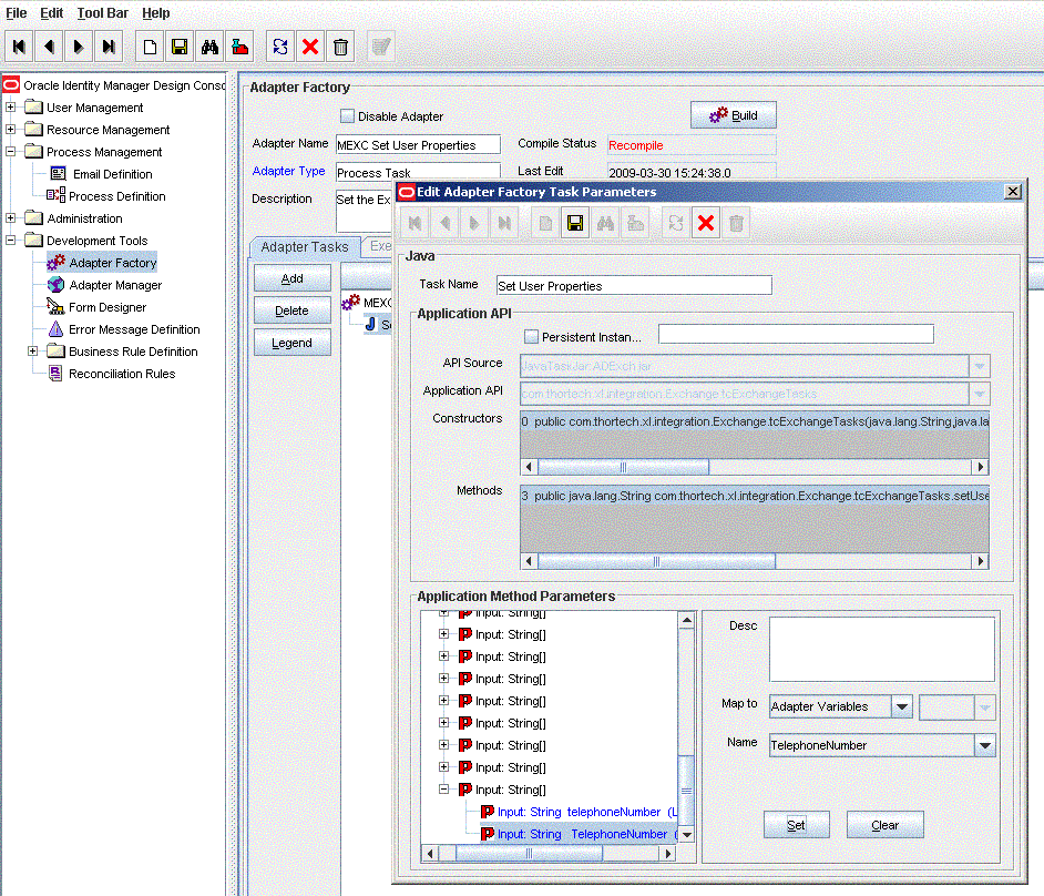

Map the string:
Map the first item to a literal. The value of the literal should be the attribute value on the target system.
Click Save. Figure 4-12 shows the string mapped to a literal in the process form.
Map the second item to the corresponding adapter variable:
Click Save. Figure 4-13 shows the string mapped to the adapter variable in the process form.
Figure 4-13 String Mapped to Adapter Variable

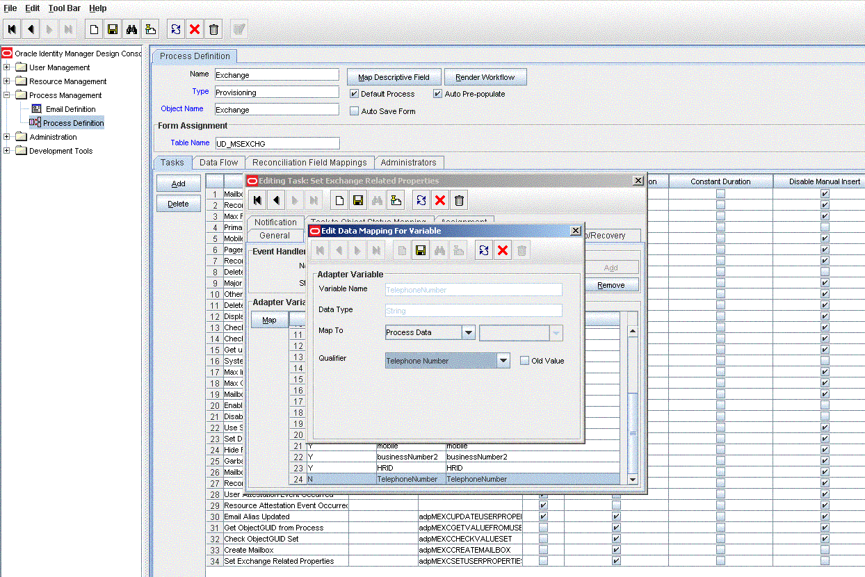

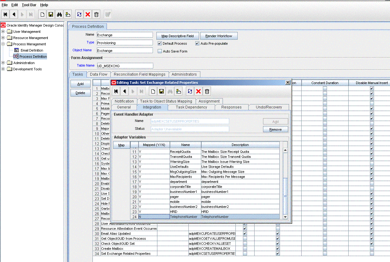

Map the variable to process data:
Select Set the Exchange Related User Properties.
Double-click Process Task and navigate to the Integration tab. The newly mapped variable will have the mapped status as N. Figure 4-14 shows the newly mapped variable in the process definition.
Figure 4-14 Mapped Variable in Process Definition
In the Map To field, select Process Data.
In the Qualifier field, select the name of the form label, which you have entered in the form.
Click Save. Figure 4-15 shows the adapter variable mapped to the process data field.
Figure 4-15 Variable Mapped to Process Data Field
