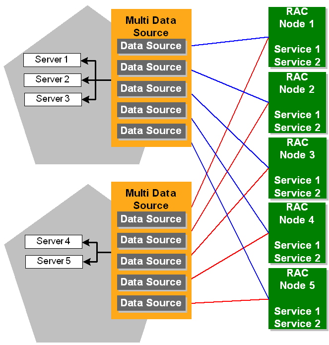

Using Multi Data Sources with Oracle RAC
To connect WebLogic Server to multiple Oracle RAC nodes using multi data sources, first configure a JDBC data source for each RAC instance in your RAC cluster with the Oracle Thin driver. Then configure a multi data source, using either the algorithm for load balancing or the algorithm for failover, and add the data sources to it.
Figure B-3 shows a typical multi data source configuration.
Figure B-3 Multi Data Source Configuration
Description of Figure B-3 follows
Description of "Figure B-3 Multi Data Source Configuration"
You can use the Administration Console or any other means that you prefer to configure your domain, such as the weblogic.Admin command line utility, the WebLogic Scripting Tool (WLST), or a JMX program. For information about configuring a WebLogic JDBC multi data source see Chapter 4, "Configuring JDBC Multi Data Sources." For information on how to configure the data sources in a multi data source to connect to services running on RAC nodes, see Configuring Connections to Services on RAC Nodes.
To use a database connection in this configuration, your applications look up one multi data source on the JNDI tree and then request a connection. The multi data source determines which data source to use to satisfy the connection request based on the algorithm type specified in the configuration (that is, failover or load balancing).
Attributes of a Multi Data Source
The multi data source may have the following attributes, depending on the role of RAC in your system—load balancing or failover:
  • AlgorithmType="Load-Balancing" or AlgorithmType="Failover"
    With the Load-Balancing option, connection requests are distributed among available data sources; with the High-Availability option, connection requests are served by the first available pool in the list. When a data source becomes defunct, connection requests are served by the next data source in the list.
  • FailoverRequestIfBusy="true"
    With the Failover algorithm, this attribute enables failover when all connections in a data source are in use.
  • TestFrequencySeconds="120"
    This attribute controls the frequency at which WebLogic Server checks the health of data sources previously marked as unhealthy to see if connections can be recreated and if the data source can be re-enabled. For more details see Chapter 4, "Configuring JDBC Multi Data Sources."
    For fast failover of RAC nodes, set this value to a smaller interval, for example, 10 (seconds).
Using Multi Data Sources with Global Transactions
Release 11.1 includes support for Oracle 11g RAC as a high-availability database solution for WebLogic Server. However, this release does not support the new Oracle Services features in Oracle 11g RAC that support XA with load balancing. Instead, WebLogic Server will continue to use its well-proven integration architecture using multi data sources for XA with load balancing.
In this configuration, a multi data source "pins" a transaction to one and only one Oracle RAC instance. Individual transactions are load balanced with the initial connection request for the transaction. Failover is handled at the multi data source level when a RAC instance becomes unavailable. If there is a failure on a RAC instance before PREPARE, the operation is retried until the retry duration has expired. If there is a failure after PREPARE the transaction is failed over to another instance.

Load Balancing
In a load balancing configuration, there are multiple services running concurrently on each RAC node. Each WLS multi data source has an active connection pool configured to connect to a given service on each of the nodes. In this scenario, you would configure each multi data source to use the Load Balancing algorithm.
Figure B-5 Load Balancing
Description of Figure B-5 follows
Description of "Figure B-5 Load Balancing"
In this example, Service 1 and Service 2 are each actively running on all of the available RAC nodes. As a result, all of the connection pools in each multi data source will actively make connections in a round-robin fashion, balancing workload among the five nodes.
Connection Pool Capacity Planning
It is important to note the Maximum Capacity value you specify for a data source can cause the connection capacity to a given RAC node to be exceeded. You must consider the following factors when determining how to set this value for each of your data sources:
  • The maximum number of simultaneous connections that a RAC node can support. This is based on the available memory on a given RAC node and the amount of memory consumed by each service connection (which can vary for each service). Memory consumption by each connection is a major limitation on the amount of work that can be generated from the WLS servers. Exceeding the amount of available memory by creating too many connections from your WLS data sources to a given RAC node can result in degraded performance on the RAC node, or could lead to failed connections.
    Available memory for a node should be based on the PGA target attribute (per session memory).
  • The maximum number of data sources that can potentially create connections to a given RAC node, and the number of WebLogic server instances to which each data source/multi data source is targeted. For example, if you have one data source that is targeted to three WLS servers, that data source counts as three data sources, as each server uses its own instance of the data source. This is the case whether the servers are part of a cluster or are independent server instances.
  • The maximum number of services that may be actively running on a given RAC node, and the memory consumed on the node by each connection to each service.
  • The expected relative workload for each service on a given node. For example, the expected workload of Service1 may be double that of the expected workload of Service2.
    Regardless of whether or not a service is always active on a node, you should allocate resources for that service in the event you have to start it on the node.
  • Always use the worst-case scenario when setting the Maximum Capacity value for your data sources. For example, assume that all available services will be actively running on the RAC node associated with each data source.
The following example explains how you could go about determining each data source's Maximum Capacity value. Keep in mind that this is a very simple example intended to illustrate the issue conceptually, and that real-world situations are much more complicated. In general, it is best to under-configure your data sources with a low Maximum Capacity value, monitor your RAC nodes for memory usage and performance, then adjust the Maximum Capacity values upward until you are approaching the maximum capacity of the associated RAC nodes.
Example
Suppose you have the following basic configuration:
  • Five RAC nodes, each with 16 GB of memory.
  • Two services actively running on each RAC node. Service1 uses 10MB per connection, Service2 uses 20MB per connection.
  • Workload for each service is the same, that is, each service will generate an equivalent number of connections on a given RAC node.
  • Two WebLogic Server clusters. Cluster1 has five servers. Cluster2 has four servers.
  • For a given RAC node, one data source is targeted to Cluster1 and is configured to connect to Service1.
  • For a given RAC node, one data source is targeted to Cluster 2 and is configured to connect to Service2.
Because Service2 uses twice as much memory per connection as Service1, you should allocate approximately 10GB of the node's memory for Service 2 and approximately 5GB for Service1.
Because Cluster1 has five WLS servers, there will be five data sources making connection requests to this RAC node. This gives you 1GB of memory available for connections from a given data source (5GB/5). Each connection requires 10MB of memory, so the Maximum Capacity value for each data source targeted to Cluster1 should be 100 or lower.
Because Cluster 2 has four WLS servers, there will be four data sources making connection requests to this RAC node. This gives you 2.5GB of memory available for connections from a given data source (10GB/4). Each connection requires 20MB, so the Maximum Capacity value for each data source targeted to Cluster2 should be 125 or lower.
If Service 2 generates more workload than Service1, you would have to adjust these values appropriately (increase the Maximum Capacity value for the data source connecting to Service2, decrease the value for the data source connecting to Service1). As long as:
(Max. connections to Service1 x memory used per connection) + (Max. connections to Service2 x memory used per connection) < Available memory
you can avoid the potential for performance degradation or connection failures.
Alternatively, in a simple configuration, such as is shown in Figure B-6, the Maximum Capacity value you specify for each of your data sources can be loosely determined using the following formula:
Maximum connection pool capacity = Maximum number of connections to RAC nodes/(Number of WebLogic Server instances x Nmber of data sources targeted to each instance x Number of active RAC services configured x Number of RAC Nodes)
where:
Maximum number of connections to RAC nodes is determined by total memory available on all nodes divided by the memory consumed by each connection.
Number of WebLogic Server instances is the number of server instances to which the data sources are targeted. If the data sources is targeted to a WLS cluster, this is the number of servers in the cluster.
In the example in Figure B-6:
  • assume that a maximum of 4000 total connections can be made to the group of RAC nodes, based on 8GB of available memory per RAC node, and 10MB of memory used per connection.
  • there are a total of five server instances to which the data sources are targeted
  • there are five data sources targeted to each server instance
  • there are two services running on each RAC node, and
  • there are five RAC nodes.
In this configuration, the Maximum Capacity value you would enter for each of your data sources would be:
Maximum connection pool capacity = 4000/(5 server instances x 5 data sources x 2 services x 5 RAC nodes)
which would give you a Maximum Capacity value of 16 for each of your data sources.
Figure B-6 Example Data Source Connection Configuration
Surrounding text describes Figure B-6 .
Keep in mind that this formula is just a general guideline for configuring your data sources, as many configurations will be too complex for you to use such a simple calculation.
