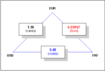

    The Rate field displays the visual rate, or in the case of triangulated exchange rates, the primary visual rate, which is typically the cross rate, but which can also be one of the other component rates of the triangle.
    You can edit the rate for non-triangulated rates, and also for triangulated rates if a quotation method is defined for the currency pair and the Cross-Rate Allow Override check box is selected on the Currency Quotation Method page. If the override is not allowed, users can update the exchange rate values to and from the reference currency on the Exchange Rate Detail page.
The following graphic represents the three component visual rates in an exchange rate from FRF to USD, triangulating through the euro. You can access all three visual rates of a triangulated exchange rate by opening the Exchange Rate Detail page.
Component visual rates in a triangulated exchange rate

Displays a quote indicating the quotation method originally used by a historic exchange rate, if the system determines that the quotation method originally used by the historic rate was different from the current quotation method. For example, the Historic Quote field displays a quote if the historic rate converted the From currency to the To currency directly using a calculated reciprocal rate, but the current quotation method for the currency pair is now indirect. The field would also display a quote if the historic quote method was non-triangulated and the current quote method is triangulated. If the system does not determine that the historic and current quote methods are different, the Historic Quote field displays Not Applicable.
Exchange Rate
Displays a single visual rate for non-triangulated exchange rates or all three component visual rates for triangulated exchange rates. The cross rate for triangulated exchange rates is editable only if the Allow Override check box is selected in the exchange rate's quotation method definition.
See PeopleSoft Enterprise Components PeopleBook for PeopleSoft Enterprise HRMS and Campus Solutions 9.0, "Working With Currencies and Market Rates," Defining Market Rates
