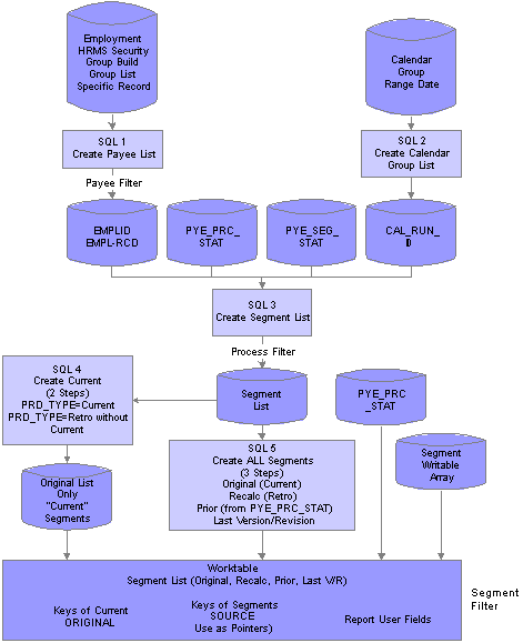

Selecting Absence Results and Populating Output Tables
After you set up the input and output table details using the Define Report Data page, and map fields and define filters on the Report Data Process Details page, the system completes the following steps to select the absence results and populate the output tables:
Select calendar groups.
Select eligible payees using payee lists, group builds, security, and payee filter. If a payee filter was created, it is applied here.
Join the payee process status table (GP_PYE_PRC_STAT) and the payee segment status table (GP_PYE_SEG_STAT).
Select the original segments. If a process filter was created it is applied here.
Insert the original, recalc, prior, and last version/revision segments into the worktable (GP_RPTW_TMP). The worktable now contains rows by payee for selected segments, recalculations, prior segments, and last version/revision segments. If a segment filter was created it is applied here.

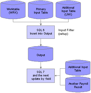

Join the worktable, the primary input table, and the link table (the additional input table joined with the primary input table) according to the data on the Report Data Process Details page. The results are posted to the output table. Only the results derived from the worktable or the primary input table are populated. If an input filter was created it is applied here.
Update the output table with data from the additional input tables.

FiltersFour levels of filters exist: payee, process, segment, and input.
Payee Filter
This SQL parameter is used to filter the population. It is applied when the selection is based on a specific record or employment table.
Process Filter
This SQL parameter is used to filter the entire process in the original segments only. It can be based on any field in the payee process status or payee segment status tables. For example, “and COUNTRY = 'USA'” selects only U.S. absence results.
Segment Filter
This field parameter is used to create a filter for every step of the process in every segment. It can be based on any field in the payee process status, the payee segment status, or the segment writable array table (if defined in the setup). For example, COMPANY 'GBI' makes a selection on the company GBI if COMPANY is stored in a segment writable array.
Input Filter
This SQL filter is defined in the setup for each step used to filter the primary input table, the additional input table joined with the primary input table (the link table), or the worktable. Input filters can be used as a filter or as an additional join condition. For example, “and PRI.CALC_RSLT_VAL>0” selects only the positive results.

Creating Input FiltersAccess the Report Data Process Details page.
SQL |
Write a where clause to execute during the selection of the primary input table. Aliases are available. For example:
Aliases available for Filter |
This legend shows that the aliases that can be used in the SQL field. Use the button to refresh the legend. Aliases are as follows:
Note. You can use specific words in your SQL where clause. For example: “and WRK.PAY_ENTITY in (%PARM.PRMARG.1)”. In this statement, the report data process will replace %PARM.PRMARG.1 with the appropriate value.
Validating Report DataThis section discusses how to validate report data.
Report Validation
The Validate Report Data page enables you to test a defined report with specific parameters so that you can validate the results. With this page you can:
Run the report data generation process in batch mode.
Run the report data generation process in real time.
Generate SQL requests.
View generated report data.

Below is a list of predefined function and parameter values.
Function |
Parameter |
Parameter Value |
Comment |
EXTPRC |
COUNTRY |
Country Code |
This parameter is required. |
EXTPRC |
NAME |
Report Data |
This parameter is required |
EXTPRC |
TYPE |
P or A or B |
Select one of the following:
SELPYE |
SECUR |
Y/N |
Use this parameter to apply security to payee selection. |
SELPYE |
RECORD |
Record Name |
Payee selection is based on this record. It must include EMPLID and EMPL_RCD. |
SELPYE |
SQL |
SQL Statement |
When the parameter value field is not long enough, the user can repeat the same parameter. The system will concatenate the different values. |
SELPYE |
GRPBUILD |
Group Build Code |
SELPYE |
GRPVER |
Group Build Version |
SELPYE |
GRPLST |
Group List Name |
SELPYE |
STREAM |
Stream Number |
Use this parameter to tell the system whether it must use EMPL_FROM/TO. |
SELPYE |
EMPLID |
Employee ID |
The same parameter can be repeated. |
SELPYE |
EMPL_RCD |
Employee Record Number |
SELCAL |
CALGRPID |
Calendar Group ID |
SELCAL |
DATE |
1, 2, 3, or 4 |
If this parameter is not defined, the system uses the period end date. |
SELCAL |
FROMDT |
From Date |
SELCAL |
TODT |
To Date |
SELCAL |
CYCLE |
1, 2, or 3 |
SELSEG |
SQL |
This is the process filter. |
SELSEG |
BALANCES |
1 or 2 |
SELSEG |
REPLACE |
Y/N |
Use this parameter to determine whether replacements are considered original. |
SEGFILTER |
Any field name on the worktable and the segment writable array (if a segment writable array is defined) |
Any Value |
This is the segment filter. The process adds WRK.fieldname to the report. |
