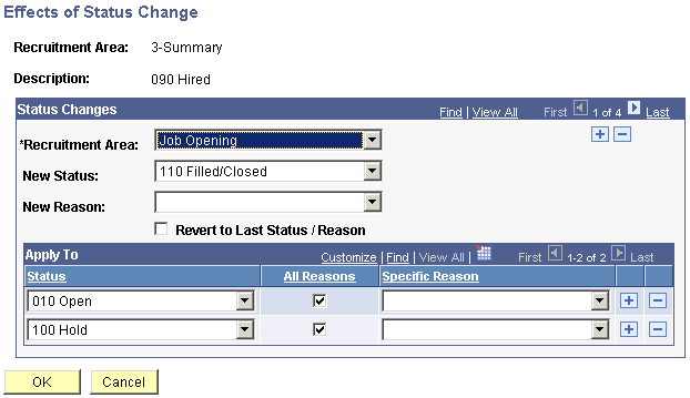

You define the rules for changing status values on the Effects of Status Change page.
For each rule, you define:
Recruitment area affected.
The records within the recruitment area that are affected by the status change.
New status and reason code that the system applies to those affected records.
Here is an example of the Effects of Status Change page for the Disposition status of Hired.
Example of the Effects of Status Change page
In this example, when an applicant’s application is set to 090 Hired,the following rule is applied:
The recruitment area that is affected is Job Opening.
The new status that the system applies is 110 Filled/closed.
Note. This example shows only one of the PeopleSoft-delivered rules for the Hired status. The Hired status has other rules that you access by clicking the navigation buttons.

Defining the Effects of Status ChangesAccess the Effects of Status Change page.
Status Changes
 Recruitment Area  |
 Use this field to identify the recruitment area that is affected by the status that is shown in the Description field. If the displayed Description status is in the Recruitment Summary area, you can select other recruitment areas that are affected by the status change. Otherwise, the system automatically selects Recruitment Summary.  |
 Affected Applicant  |
 Available in Recruitment Summary area. Select Current Applicant - Current Job if the new code should be applied to the current applicant that is linked to the current job where the status change is being made. Select Current Applicant - Other Jobs if the new status and reason should be applied to the other positions that the current applicant has been linked to. Select Other Applicants - Current Job if the new status and reason should be applied to other applicants that are linked to the same job and no more openings on the job are available.  |
 New Status  |
 Select the status that is applied to the affected records.  |
 New Reason  |
 Select the reason that is applied to the affected records.  |
 Revert to Last Status/Reason  |
 Select this check box if the status reverts to the previous status and reason code that was assigned. Leave the New Status and New Reason fields blank if you select this check box.  |
Apply To
 Status  |
 Select the statuses that are affected by the status change. You can choose from the status values that are defined for the recruitment area that you selected in the Status Changes group box. If the status change should be applied to all reason codes that are associated with the status, select the All Reasons check box. Otherwise, select one reason code in Specific Reason.  |
