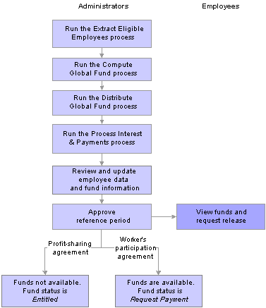

Profit sharing processes
The four profit sharing processes that must be run are:
Extract Eligible Employees.
This is the first process that you must run. It compiles a list of employees who are entitled to share the global fund. It also imports payroll information for eligible employees from PeopleSoft Enterprise Global Payroll for France or from a specified record in the database.
Compute Global Fund.
This process calculates the global fund available, based on the funding formulas defined in the agreement. For worker's participation agreements, there can be multiple formulas for different establishments or groups of employees (work units).
Distribute Global Funds.
This process divides the global funds calculated by the Compute Global Fund process and distributes the fund according to the distribution methods specified in the agreement definition.
Process Interest and Payment.
This is the final process that you must run. This process has a dual role: it completes the profit-sharing calculations and also processes payments. The process calculates deductions for employees' funds and calculates interest that is due for profit-sharing funds, using the Company Investment investment method. If you integrate your system with Global Payroll for France or another payroll system, the Process Interest and Payment process manages payments for profit sharing and worker's participation agreements.
Typically, you run the first three processes (Extract Eligible Employees, Compute Global Fund, and Distribute Global Funds) once for each reference period. However, you run the Process Interest and Payment process at intervals, because it processes payments, updates interest amounts and fund status, and calculates funds.
Compensation administrators can review the results of each process and make any adjustments necessary before running the next process in the sequence. The Member Entitlements component provides administrators with a view of the results generated by the eligibility and calculation processes. In addition, compensation administrators can rerun processes before moving on to the next stage.

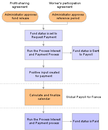

Integrating with Global Payroll for France
If you installed Global Payroll for France, you can use it to automatically process payments, as this diagram shows:
Overview of payment processing
Integrating with Other Payroll Systems
To integrate the Manage French Profit Sharing business process with a payroll system other than Global Payroll for France, you must set up the integration points that enable payment information to be exchanged.
See Interactive Services Repository in the Implementation Guide section on Customer Connection.

Page Used to Run the Process Interest and Payment Application Engine Process (HR_WP_PAYMT)|
Page Name |
Object Name |
Navigation |
Usage |
RUNCTL_WP_PAYMT |
Compensation, Profit-Sharing FRA, Compute Profit-Sharing, Process Interest & Payment, Payment Process |
Run the process for a selected agreement and reference period. |
Running the Process Interest and Payment Application Engine Process (HR_WP_PAYMT)Access the Payment Process page.
Agreement ID |
Select the agreement for which you want to run the process. |

Reviewing the Results of the ProcessesWhen you run any of the profit sharing processes, you must check the message log generated by the process for errors or warning messages. Navigate to the message log from the run control pages as follows: Process Monitor, Details, View Log/Trace.
You can view the results of the process by using the Member Entitlement component, which lists the eligible employees and the results of the calculations.
See Also
Reviewing and Reporting Employee Profit Sharing Information
Approving the Reference PeriodWhen you have run all of the profit sharing processes and you are satisfied with the results, you must change the status of the reference period to Approved. Use the Reference Period component to change the status. Navigate to the component as follows: Compensation, Profit-Sharing FRA, Review Reference Period, Reference Period.
Note. Employees cannot view their profit-sharing funds until you change the reference period status to Approved.
