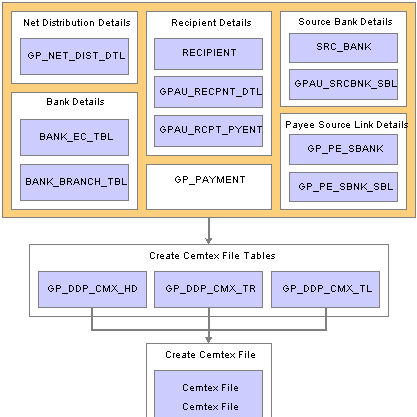

Managing Electronic Fund TransfersThe Australian standard Cemtex file for EFT is created by a process that provides multiple options to control the file's content. You can create an EFT file that contains:
Group tax.
Net pay distribution.
Recipient deduction.
Net pay and recipient.
The following diagram shows the tables that contribute data to the Cemtex file that is incorporated into the EFT file.
Tables that contribute to the Cemtex file
Note. You must finalize the Banking process (GP_PMT_PREPARE) before you can create the Cemtex file. After the Cemtex file is created, the system changes the PMT_STATUS field in the GP_PAYMENT table from P (prepared) to T (transferred).
