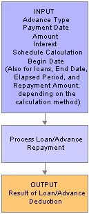

Click to jump to top of pageClick to jump to parent topicLoan and Advance Repayments in the Pay Process Flow
This diagram illustrates how loan and advance repayments fit into the overall pay process flow of Global Payroll for Spain. Loan and advance repayments are voluntary deductions, which are deducted after statutory deductions. They appear in the process list after the statutory deductions.
Loan and advances process flow
