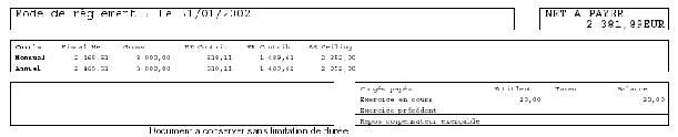

Sample header of a payslip
Sample body of a payslip
Sample footer of a payslip
