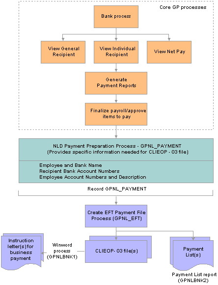

Understanding Banking Processing for the NetherlandsIn addition to the core payroll and banking process, there are three processes specific to banking for the Netherlands:
The Payment Preparation Application Engine process (GPNL_PAYMENT) extracts data from the core application record GP_PAYMENT and populates the record GPNL_PAYMENT with information required for the CLIEOP-03 file.
The Create EFT Payment File Application Engine (GPNL_EFT) process extracts the data from GPNL_PAYMENT to create a CLIEOP-03 file and Instruction letter for business payments to either bank accounts and/or postbank accounts, depending on the selection you make on the run control page.
The Payment List report produces a list of employee and recipient payment detail suitable for payroll administrators and accountants to use for general management of salary payments and general payroll administration.
This diagram illustrates how the banking processes for the Netherlands supplement the core application banking process:
Global Payroll for the Netherlands banking processes
