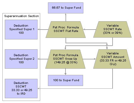

Click to jump to top of pageClick to jump to parent topicSuperannuation and SSCWT
Superannuation deductions can have the SSCWT amount calculated by the flat rate method or the gross up method. For either method the rate can be the normal amount rate or the alternative rate.
For an employer contribution of 100 at the normal rate (33 percent in the example):
The employee can elect to have either calculation method use the higher rate.
The following diagram shows an overview of the process. The example shows 33 percent and 39 percent as the Variable SSCWT rate but the example amounts are based on 33 percent .
Two methods of calculating SSCWT
