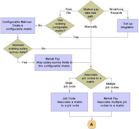

The Market Pay Process FlowFollow these steps to set up the market pay functionality:
Define geographical areas.
Select an existing configurable market pay matrix, or create a new one.
(Optional) Map existing salary survey data fields to a configurable matrix definition.
Associate a market pay matrix to job codes.

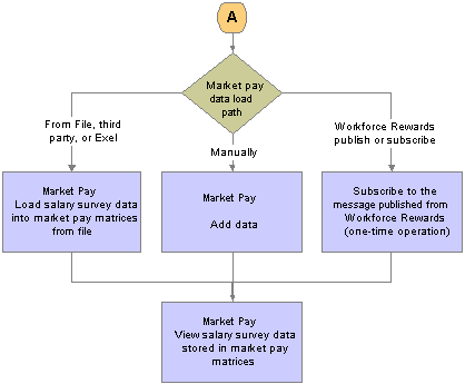

Load market pay data by one of three methods:
Load data from file using an automated process.
(Workforce Rewards users only): Subscribe to message published from Workforce Rewards.
Set up Integration Broker messaging to subscribe to the message published by Workforce Rewards.
Manually enter data.
View market pay data online by job code.
These diagrams illustrate the market pay process flow.
Creating a configurable matrix and associating job codes
Loading data into the market pay matrix
