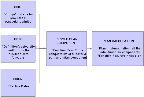

Modular Approach to RulesPension Administration takes a modular approach to setting up calculation rules. Use different modules to establish:
A calculation rule that is based on one of the core functions. This is a definition module.
A calculation rule that is based on who uses the rule. This is a group module.
When you put together a complete rule, you mix and match definitions and groups to specify who uses which calculation method and when.
Assemble modular rules to create a pension plan calculation

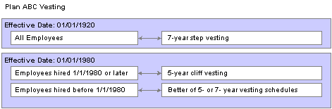

For example, assume that your plan vesting rules change from seven-year step vesting to five-year cliff vesting in 1980. Employees hired before January 1, 1980 can use the better of the two rules; those hired afterwards must use the five-year cliff vesting.
Your complete rules have two effective dates. First, from the inception of the plan until 1980, there’s one rule (step vesting) available to all employees. Second, after January 1, 1980, employees hired after the change use the new rule (cliff vesting) while employees hired before the change use the better of the two rules.
You need to set up the following modules:
Vesting definition 1: Seven-year step vesting.
Vesting definition 2a: Five-year cliff vesting.
Vesting definition 2b: Better of the two vesting methods.
Group 1: All employees.
Group 2: Employees hired January 1, 1980 and later.
Group 3: Employees hired before January 1, 1980.
Note. In reality, each of these modules would reference other modules.
Your rule looks something like this:
Vesting rules example
