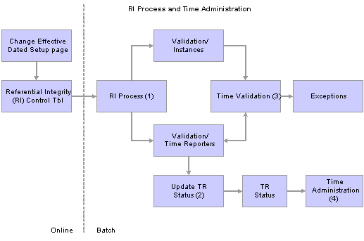

Referential Integrity Triggers
When you change an effective-dated setup object, these events occur:
The system determines whether or not that change affects any reported or payable time.
If a change affects reported or payable time, the system writes a row in a control record to identify the setup change and any validations to be run as a result.
The Referential Integrity process triggers the Time Validation process.
The Time Validation process checks for any reported or payable time that is negatively affected by the setup change and triggers exceptions for invalid elements. If validation is unnecessary, the Referential Integrity process triggers Time Administration to reprocess payable time that is affected by the setup change.
When Time Administration runs, it initiates a separate RI review process.
The RI process determines whether any rows exist in the control record to identify setup changes. If rows exist in the control record, the RI process determines which time reporters are affected by each change in the record. The affected time reporters will:
Change their Time Administration status so that they are selected for Time Administration processing.
Set their earliest change date to the first instance of reported or payable time that is equal to, or greater than, the effective date of the setup table change.
Run the Time Validation process against reported time that is equal to or greater than the new earliest change date.
Time Administration continues processing.
The process runs rules, runs Time Administration Validation, and creates payable time based on the updated earliest change date.

This flow chart shows the high-level view of the RI process and Time Administration process:
Referential Integrity Process and Time Administration
