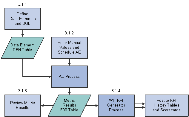

You must run the following jobstreams to populate key tables:
KP_ANALYZE
This jobstream populates KP_KPI_CALC_F00 and KP_KPI_ASMT_F00. Run this jobstream to validate the KPI calculation rules, verify end values, and test the KPI assessment rules.
BC_ANALYZE
This jobstream populates KP_KPI_CALC_F00, KP_KPI_ASMT_F00 and BC_ASSESS_F00. Run this jobstream to generate the final scorecard assessments after you validate your setup (by running KP_ANALYZE). If you set up this job to run regularly, the KPI process can aggregate data month-to-month and year-to-date. You must run this process after you populate or update the Performance Management Warehouse tables (such as during the Extract Transform and Load process) to view current results for your manufacturing scorecard.

The Manufacturing Scorecard, provides you with the ability to manage the metrics that formulate the KPIs. Here you can define the root data element values and the associated SQL, financial data, or manual input used to extract the metrics from the Performance Management Warehouse Doing so allows you to easily configure the metric derivations without having to navigate through all of the Performance Management Warehouse and KPI configuration pages.
You can use the Define Calculations component to define the data element IDs that are used to calculated the scorecard metrics. The configuration settings are stored in the MFG_KPIVAL_DFN table. They are keyed by data element ID and are global to the Performance Management Warehouse (that is, they are not keyed by setID or business unit).
You then request the system to calculate the metrics for a specific business unit and fiscal period. The system reads the data element definitions from the MFG_KPIVAL_DFN table and allows you to override any manual KPI values. You schedule the Calculate Manufacturing KPI Metrics (MFG_KPI_CALC) application engine. This engine reads the data element definitions and carries out the specific logic to resolve metric calculations. The engine carries outthe logic for each data element defined for the Manufacturing Scorecard and writes the results along with any manual KPI entries to the MFG metric F00 table (MFG_KPIVAL_F00). The results are keyed by business unit and transaction date such that the PF KPI Generator process can select data values using the standard Enterprise Scorecard assessment logic.
You can review the results for any fiscal period from the MFG_KPIVAL_F00 table.
The PF KPI Generator process refers to the MFG_KPIVAL_F00 table to resolve the final KPI calculations and post to the scorecard.
The following graphic illustrates the calculation process flow:
