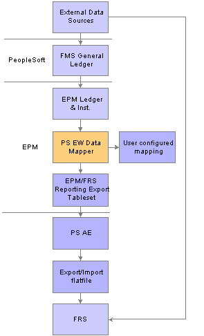

The following high-level diagram highlights the overall data processing flow and functionality. The objects in gray represent new elements comprising this new module.
Data processing flow overview
The External Data Sources object represents the System of Record as well as any other external sources of financial and relationship data.
The User Configured Mapping represents the module that allows you to define the mapping of your ledger and instrument balances into FRS product, type (profit/loss) codes and regulatory reporting business units.
PeopleSoft supplies a set of export tables suitable for import into FRS.

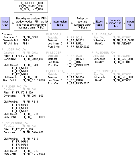

Click to jump to top of pageClick to jump to parent topicGenerating Regulatory Reporting Export Files
The FRS Connector is essentially a set of three stage AE processes consisting of a Data Mapper stage, an AE job to roll-up accounts by regulatory reporting business units, and an AE job to generate the resulting import files. Basically the job begins with one of the three views as input and results in one of three import flat files.
In the following diagram, items in gray text are predefined. Items in black text need to be defined as part of an implementation.
The FRS Connector process flow and implementation-required metadata definitions.

Steps to generating export files for regulatory reporting systems
Initial Implementation and infrequent changes:
  1. Ensure that FRS Product and Profit/Loss code lists are current for your implementation.
  2. Define regulatory RBUs.
  3. Ensure that any and all Performance and Warehouse business units are defined.
  4. Define any and all scenarios that will be associated with the export runs.
  5. Define any and all filters and constraints for: PS General Ledger (DataMap: FI_FR_D011), Global Consolidation (DataMap: FI_FR_D010) and FSI Ledger (DataMap: FI_FR_D012).
  6. Define Data Mapper Rule Sets.
  7. Define Data Mapper Value Mappings (if required).
  8. Define Data Mapper Rule Groups.
  9. Define all metadata Data Sets for roll-ups by RBU.
  10. Define Run Control Templates for Data Mapper and RBU roll-ups.
  11. Set Data Mapper Run Control Values corresponding to the Run Control Templates.
  12. Set Regulatory Reporting Center Runtime Parameters corresponding to the RBU roll-up Run Control Templates.
  13. Define Process Scheduler processes and jobs for generating import files from the export tables.
For each run:
  1. Run the Data Mapper job for the source table, period, regulatory RBU and ledger (that is, FI_FR_RCID.0000, FI_FR_RCID.0001 or FI_FR_RCID.0002).
    Note. Since non-RBUs (performance business units) might have a many-to-one relationship to the RBU, you might have to run the Data Mapper more than once (that is, once for each BU in a RBU) prior to running the RBU roll-up job.
  2. Run the corresponding RBU roll-up (that is, FI_FR_RCID.0022, FI_FR_RCID.0021 or FI_FR_RCID.0020).
  3. Review the resulting RBU roll-ups. (optional)
  4. Run the corresponding import file generating AE (that is, FI_FR_AE002F, FI_FR_AE001F or FI_FR_AE000F).

  1. FI_FR_RCID.0002 – Data Mapper job for the source table, period, regulatory reporting business unit and ledger.
    Note. Since non-RBUs (performance business units) might have a many-to-one relationship to the RBU you might have to run the Data Mapper more than once (that is, once for each BU in a RBU) prior to running the RBU roll-up job.
  2. FI_FR_RCID.0020 – The corresponding RBU roll-up.
  3. FI_FR_AE000F – The corresponding import file generating AE.
