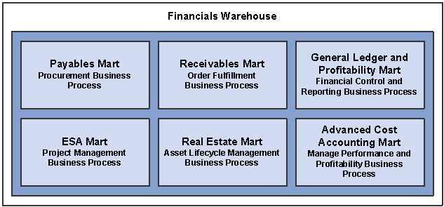

Financials Warehouse StructurePeopleSoft marts are subsets of PeopleSoft Financials Warehouse and are the foundation for the reporting applications. Marts are subject-specific relational schemas created for a particular group of users for multidimensional analysis and reporting. Each core functional area of the warehouse has predefined marts. PeopleSoft Financials Warehouse includes the General Ledger and Profitability Mart, Receivables Mart, Payables Mart, Enterprise Service Automation (ESA) Mart, Real Estate Mart, and Advanced Cost Accounting Mart.
Financials Warehouse marts and business processes
Each mart is associated with a business process that helps you to answer the questions you need to keep your organization robust and ahead of its competition. With each mart, we present the fact tables that will help you answer your critical business questions.
Note. Although we list only the actual fact name, all facts that represent dollar amounts have three facts in the fact table, one
for each possible selected reporting currency. Populating the facts for alternate currencies is optional.
For additional details of facts, see the PDF file that is published on CD-ROM with your documentation.
This section discusses:
Receivables Mart
Payables Mart
Real Estate Mart
Receivables Mart Accounts receivable are often the largest asset on a company’s balance sheet and are critical to its financial health. While extending credit to the customers helps boost sales, it also increases the cost of working capital and financial risk, especially in challenging economic times.
You use the Receivables Mart to analyze your company’s receivables. With it you can perform multidimensional analysis against your receivables activities and receivables information to see how much is due from customers, view accounts receivable transactional activities, analyze customer credit worthiness and risk, and conduct account receivable account level analysis.
Receivables Mart helps you identify areas within your organization contributing to higher days sales outstanding, increased credit risk, poor collection performance, or more bad debt write-offs. In essence, it helps you better understand your receivables asset and identify areas for improvement within your organization that will enable you to improve the quality of your accounts receivable and reduce the cost of working capital.
Order Fulfillment Business Process
Receivables Mart is related to PeopleSoft’s Order Fulfillment business process, which is also known as Order to Cash. The Order Fulfillment business process fulfills an organization's requirements for capturing, fulfilling, and settling goods sold. With the Order Fulfillment business process, you capture, confirm, and manage sales orders and contracts, deliver goods or services, and then invoice, collect, and resolve payment. The Order Fulfillment business process also helps you to manage returns and inventory, process customer payments, and maintain profitable customer relationships. The information captured within the Order Fulfillment business process helps you determine answers to questions such as “What are my cost per sales?”, “What is my ending receivables balance?” and “What is my bad debt compared to sales?”
Process Customer Payments is the business sub-process related to the Receivables Mart, where you receive and apply customer payments, maintain customer balances, manage past due accounts, and resolve payment discrepancies.
