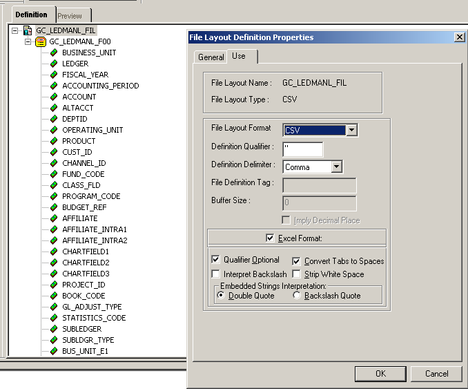

Here is an example of the delivered sample file layout for the ledger upload process in PeopleSoft Application Designer:
GC_LEDMANL_FIL File Layout Definition
The properties explain the file type and layout that your source files need to posses to load successfully. For example, the GC_LEDMANL_FIL file layout maps to the target GC_LEDMANL_F00 record. It uses a CSV file with a comma delimiter in an Excel format. The definition page shows you the columns and column order defined for the file layout.

To provide an additional solution for ledger data spreadsheet uploads, Global Consolidations has included the (GC_LEDMANL_F00) component interface.
Note. It is a good practice to make a copy and rename the delivered ExceltoCI.xls file from your PeopleTools Excel installation directory into a separate directory so that any changes you make to this file do not get overwritten by a PeopleTools upgrade.
Here is an example of where you can find the ExceltoCI.xls file on a client loaded with the PeopleTools application.
