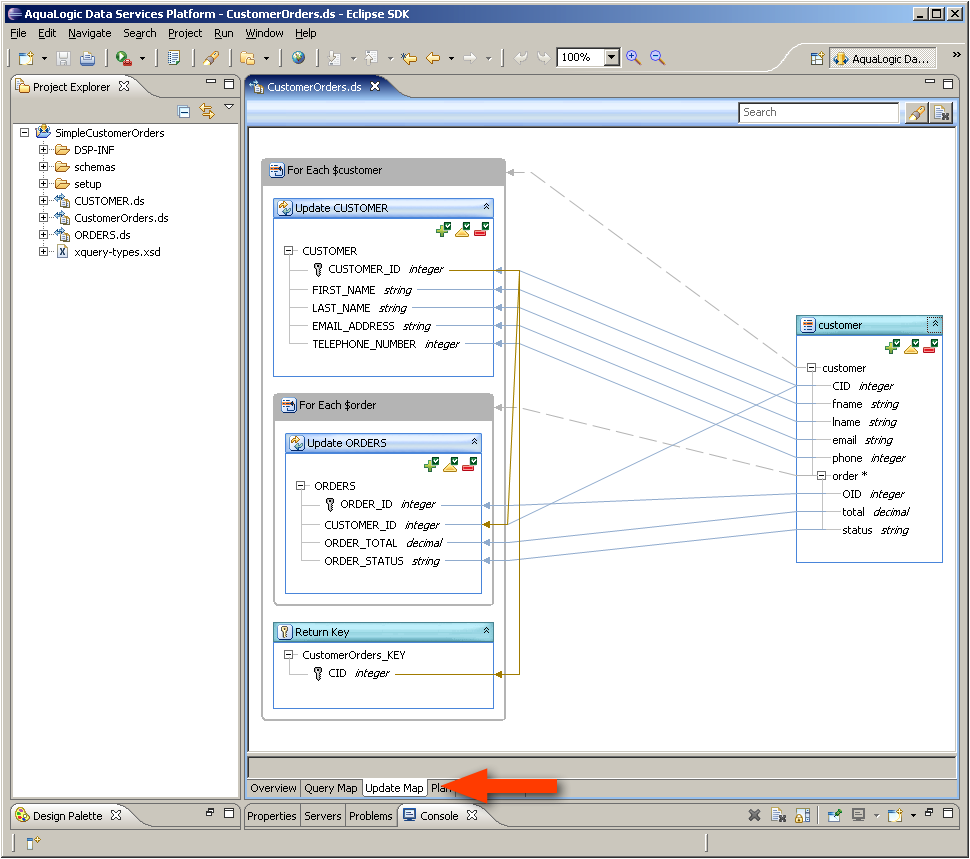

Oracle Data Service Integrator generates a default update map automatically when you create a logical entity data service with a primary read function. You can see the update map associated with a data service by clicking the "Update Map" tab at the bottom of the screen (see the example that follows; click to enlarge image).

The image to the left shows the update map for the data service (CustomerOrders.ds). The orange arrow identifies the location of the "Update Map" tab. |
An update map procedure is a create, update, or delete procedure that is implemented by an update map. The update map maps values from the input to the update map procedure to the inputs of the procedures in the underlying data services. These underlying data services that the logical entity data service is composed of are referred to as the source data services. In the previous example, the input is mapped to the two source data services CUSTOMER and ORDERS. The blue arrows in the update map show how the values are mapped.

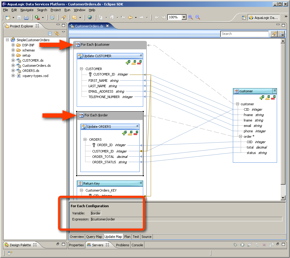

For Each Blocks
A for each block loops over elements in the input to the update map procedure. A for each block is associated with a variable and a path expression. The path expression defines the sequence to iterate over and the variable binds to elements in the sequence. The variable may be referenced by expressions inside the for each block.
The image to the left shows the update map for the data service CustomerOrders.ds. The two orange arrows identify the two for each blocks in the map. The blocks are grey and have the title "For Each" followed by the variable name.
The second for each block titled "For Each $order" is currently selected (to select a for each block, click on it). The orange rectangle identifies the properties of the currently selected for each block. In this case we see that it defines the variable $order which iterates over the sequence $customer/order. $customer is a variable defined by the upper for each block. |

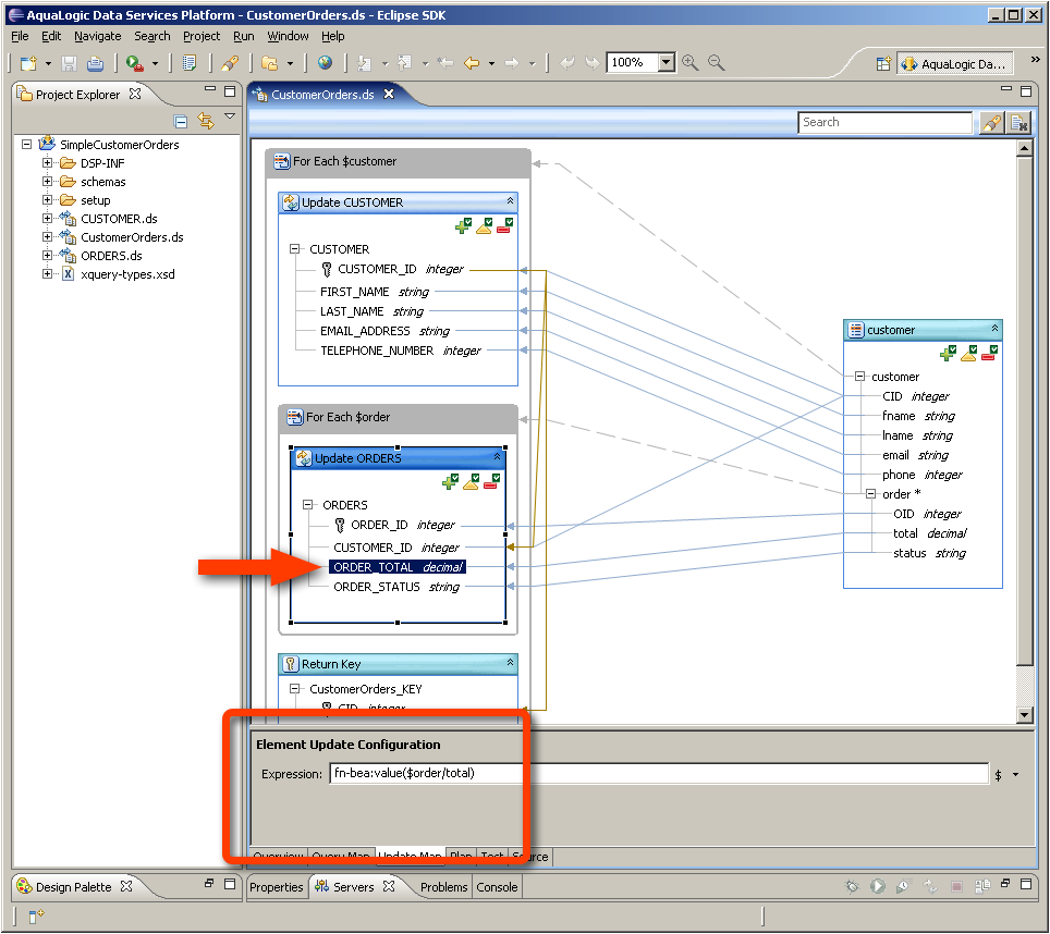

In the second image, the orange arrow identifies the ORDER_TOTAL element of the ORDERS update block. The orange rectangle identifies the mapping expression ($fn-bea:value($order/total)) for ORDER_TOTAL which is displayed because ORDER_TOTAL is currently selected. The ORDER_TOTAL element will receive the value of the total element when the source data service procedure is invoked.

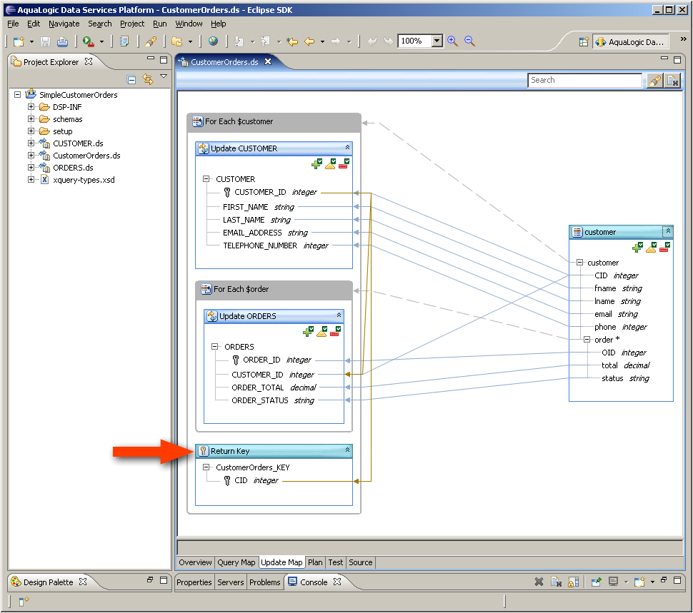

The Return Key Block
The key block describes what will be returned by the update map create procedure. If the data service does not have a key specified, then there will not be a key block and there will never be more than one key block for an update map.
The image to the left shows the update map for the data service CustomerOrders.ds. The orange arrow identifies the key block in the update map. The key specified for the CustomerOrders data service is the element CID so the key block constructs the CID element to be returned and uses the output variable of the CUSTOMER update block to get the value.

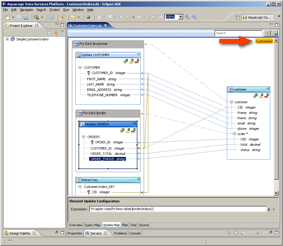

The image to the left shows the update map for the data service CustomerOrders.ds. The orange arrow identifies the "customized" symbol that appears after something in the update map has been changed. In this case, it is the mapping expression for ORDER_STATUS that has been modified.
Clicking the Customized icon and choosing View Customization from the menu displays a dialog showing the current customizations to the update map, including the enabling of update blocks, any conditions that have been set, and any changes to the mappings. This can help you to identify potential problems with the update map that might occur after you make a change to the primary read function, for example. If a problem has been identified, clicking OK accepts the correction and generates a new update map.
