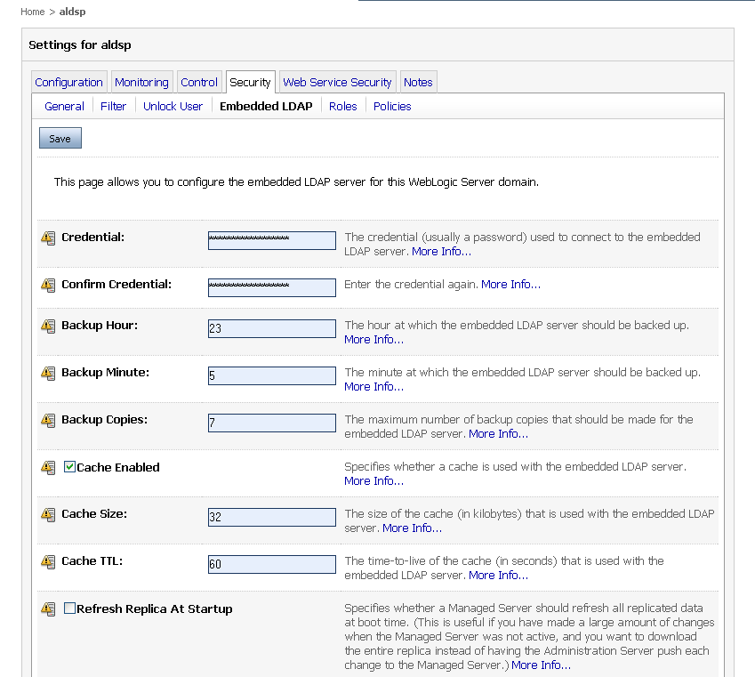

Setting the Embedded LDAP Server CredentialsYou need to set the credentials for the embedded LDAP server to match the password configured for the sample application. To configure the LDAP server credentials:

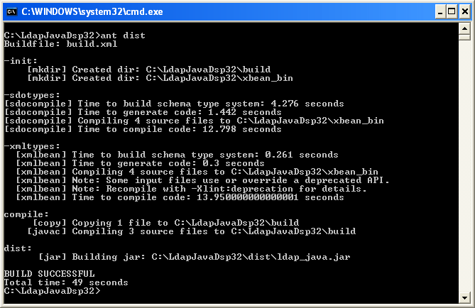

Building the Sample ApplicationThe next step involves building the sample application, including the Java Spring LDAP classes. In a terminal window set up the Ant environment by running the following command:
<WEBLOGIC_HOME>/server/bin/setWLSEnv.cmd To build the sample application:
ant dist This builds the Java Spring LDAP classes.
Testing the Sample ApplicationYou can test the sample application against the LDAP server. To test the sample application run the following command to test the Java Spring LDAP classes:
ant test-app You should see output similar to that shown in the following screen capture.
