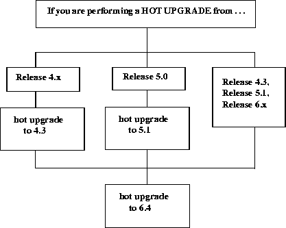

Hot Upgrade from Release 4.x
Step 1: Hot Upgrade from Release 4.2.x to Release 4.3
Now you have a configuration with the master running Release 4.3.

Hot Upgrade from Release 5.x or Release 6.x
Step 1: Hot Upgrade from Release 5.0 to Release 5.1
This step is not necessary on any platforms other than SCO.
Now you have a configuration with the master running Release 5.1.
This section is for customers running Release 5.1, Release 6.1, or Release 6.2.
