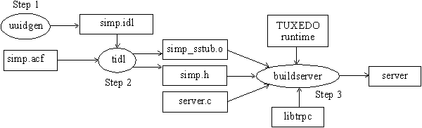

Fig. 2: Building an RPC Server
In Figure 2, the process for building a server is illustrated.
Step 1:
Run uuidgen to generate a skeleton IDL file (simp.idl) with a UUID. Edit the template IDL file to define the interface between the client and server using the interface definition language.
Step 2:
Run the IDL compiler (tidl) using simp.idl and optional simp.acf to generate the interface header file and the server stub object file.
Step 3:
After writing the server application code (server.c), run buildserver to compile it and link it with the server stub, and TUXEDO runtime, and TxRPC runtime to generate an executable server.

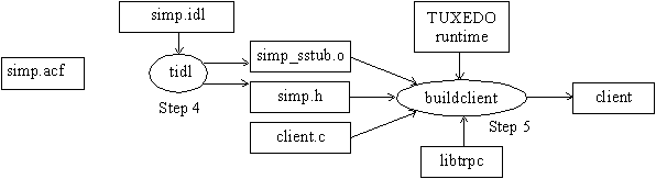

Fig. 3: Building an RPC Client
The process for building a client is illustrated in Figure 3.
Step 4:
Using the IDL file created in Step 1, run the IDL compiler (tidl) to generate the interface header file and the client stub object file.
Step 5:
After writing the client application code (client.c), run buildclient to compile it and link it with the client stub, TUXEDO runtime, and TxRPC runtime to generate an executable client.
