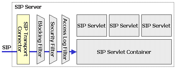

Use the SIP Server --> Transports --> SIP tab to define the transport on which this SIP server listens for SIP messages.
| Attribute Label | Description | Value Constraints |
| Transport Type | Specifies the type of the transport on which this server listens for SIP messages. "TLS" is not supported. MBean: ConnectorMBean Attribute: Transport |
"UDP","TCP" |
| Interface Address | Specifies the IP address of the NIC that this server uses to receive and send SIP messages. MBean: ConnectorMBean Attribute: Host |
IP address |
| Port number | Specifies the port number that this server uses to receive and send SIP messages. MBean: ConnectorMBean Attribute: Port |
Minimum: 1 Maximum: 65535 Suggested Value: 5060 |
| Enabled upon Startup | Specifies whether this SIP transport is enabled or not at this server startup. | "true", "false" Default: "false" |
| Right or wrong of use of load balancer | It is specified whether this SIP transport communicates by load balancer. When load balancer is invalid, this setting is disregarded. |
"enable","disable" default: "disable" |
