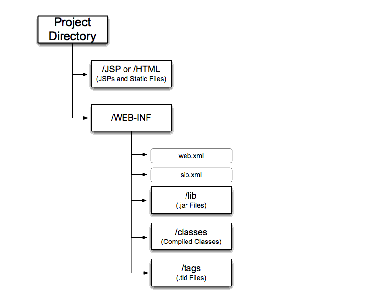

SIP Servlet Organization
Building a SIP Servlet produces a Web Archive (WAR file or directory) as an end product. A basic SIP Servlet WAR file contains the subdirectories and contents described in Figure 1.
Figure 1 SIP Servlet WAR Contents

  9. Right-click on the name of your project and use the New->Folder command to recreate the directory structure shown in Figure 1, SIP Servlet WAR Contents.
