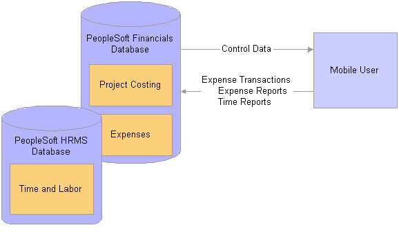

PeopleSoft Mobile Time and Expense Integrations
PeopleSoft Mobile Time and Expense integrates directly with PeopleSoft Expenses and integrates indirectly with PeopleSoft Project Costing and PeopleSoft Time and Labor.
Integrating PeopleSoft Mobile Time and Expense with other PeopleSoft applications
Serves as PeopleSoft Mobile Time and Expense gatekeeper, downloading control data directly from PeopleSoft Expenses to PeopleSoft Mobile Time and Expense. Time and expense reports synchronize directly to PeopleSoft Expenses. |
Indirectly exchanges ChartFields and time data for project costing. This is an indirect integration through PeopleSoft Expenses. |
Processes time reporting data used to create pay sheets. This is an indirect integration through PeopleSoft Expenses. |
We cover integration considerations for PeopleSoft Mobile Time and Expense in the PeopleSoft Enterprise Expenses 9.0 PeopleBook.
