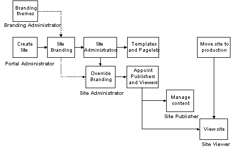

The following graphic illustrates the Site Management process flow.
Site Management flow.
The functions of Site Management can be performed by users or roles appointed by the portal administrator.
A branding administrator creates branding theme elements that can be used on sites.
A portal administrator creates a site, authorizes site branding, appoints site administrators, and selects templates and pagelets available to the site.
A site administrator can override branding themes (if authorized), appoint site publishers and viewers, set default security and templates, and configure the site's front page.
A site publisher can manage site navigation and content.
A site viewer can view the site.
