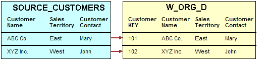

Category 1 customizations involve extracting additional columns from source systems for which pre-packaged adapters are included (for example, Siebel or Oracle) and loading the data into existing data warehouse tables. For Category 1 customizations, data can also come from non-packaged sources, but this section assumes that the sources have already been mapped with a Universal adapter and only need to be extended to capture additional columns. (The initial mapping of a Universal adapter is considered a Category 3 customization. For information, see Category 3 Customizations: Adding New Data as a Whole Row into a Standard Dimension Table.)
In order to see additional columns in the data warehouse, the columns must first be passed through the ETL process. The existing mappings and tables are extensible. Sample placeholders demonstrate how to pass and store additional data. Oracle BI Applications provides a methodology to extend preconfigured mappings to include these additional columns and load the data into existing tables.

Slowly changing dimensions work in different parts of a star schema (the fact table and the dimension table). The figure below shows how an extract table (SOURCE_CUSTOMERS) becomes a data warehouse dimension table (W_ORG_D). Although there are other attributes that are tracked, such as Customer Contact, in this example there is only one historically tracked attribute, Sales Territory. This attribute is of historical importance because businesses frequently compare territory statistics to determine performance and compensation. Then, if a customer changes region, the sales activity is recorded with the region that earned it.
This example deals specifically with a single day's extract, which brings in a new record for each customer. The extracted data from SOURCE_CUSTOMERS is loaded into the target table W_ORG_D, and each record is assigned a unique primary key (ROW_WID).
However, this data is not static; the next time a data extract shows a change for your customers in W_ORG_D, the records must change. This situation occurs when slowly changing dimensions are invoked. The figure below shows that records for the two customers, ABC Co., and XYZ inc. have changed when compared with the figure below. Notice that ABC's Customer Contact has changed from Mary to Jane, and XYZ's Sales Territory has changed from West to North.
