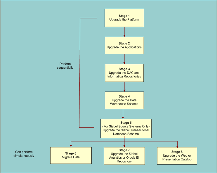

If the DAC is not a component of your Analytics installation, you are running Siebel Analytics 7.5.x.Figure 2-1 shows the upgrade flow for the major stages of the Siebel Business Analytics and Oracle BI Applications upgrade process. Depending on the prior release from which you are upgrading, you may find minor changes in the process shown in Figure 2-1.
Table 2-1 provides the documentation you should refer to for each stage of the upgrade.
In general, you must complete stages one through five sequentially, in the following order: 1) upgrade the Siebel Business Analytics platform or Oracle BI Infrastructure to the current release of Oracle BI Infrastructure; 2) upgrade the Siebel Business Analytics Applications or Oracle BI Applications to the current release of Oracle BI Applications; 3) upgrade the metadata in the DAC and Informatica repositories; 4) upgrade the data warehouse schema; 5)(For Siebel source systems) upgrade the Siebel transactional database schema.
You can perform stages six through eight simultaneously; that is, you can migrate data into the upgraded data warehouse (stage six), upgrade the Siebel Analytics or Oracle BI repository (stage seven), and upgrade the Web (Presentation) catalog (stage eight) at the same time. However, you cannot test the results of your Web (Presentation) catalog upgrade until you have finished migrating your data.
Depending on the prior release from which you are upgrading, you may find minor changes in the process described in this section.Table 2-1 Major Stages of the Oracle BI Applications Upgrade and Related Documentation
