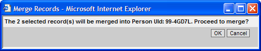

From the application-level menu, choose Edit, then Merge Records.
A dialog box appears, displaying the Row # of the surviving record. Use the numbers you recorded before the merge to make sure the correct record survives.
Note: If the Merge Records command is unavailable, the feature is not supported for the record types you have selected. |
Click OK to complete the merge.
