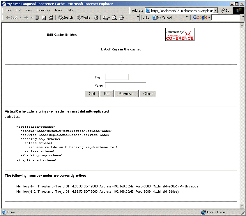

The examples/jsp/explore/SimpleCacheExplorer.jsp is the JSP file that can be used with your favorite application server:
As with the command line application please try adding, updating and removing entries from multiple instances of the application server. Also please notice the information about the cache configuration and cluster membership at the bottom of the page. As cluster members are added and removed, this information will change.

After the changes are saved, the test intances are restarted and you have had a chance to do some test data entry to see how the cache behaves, you should see the following in the cache configuration section of the tests:
Command: info >> VirtualCache cache is using a cache-scheme named 'default-distributed' defined as: default-distributed DistributedCache default-backing-map >> The following member nodes are currently active: Member(Id=1, Timestamp=Mon Jun 27 09:49:37 EDT 2005, Address=192.168.0.247, Port=8088, MachineId=26871) Member(Id=2, Timestamp=Mon Jun 27 09:49:43 EDT 2005, Address=192.168.0.247, Port=8089, MachineId=26871) <-- this node Command:
As you can see, our VirtualCache cache is now distributed according to the cache configuration descriptor.

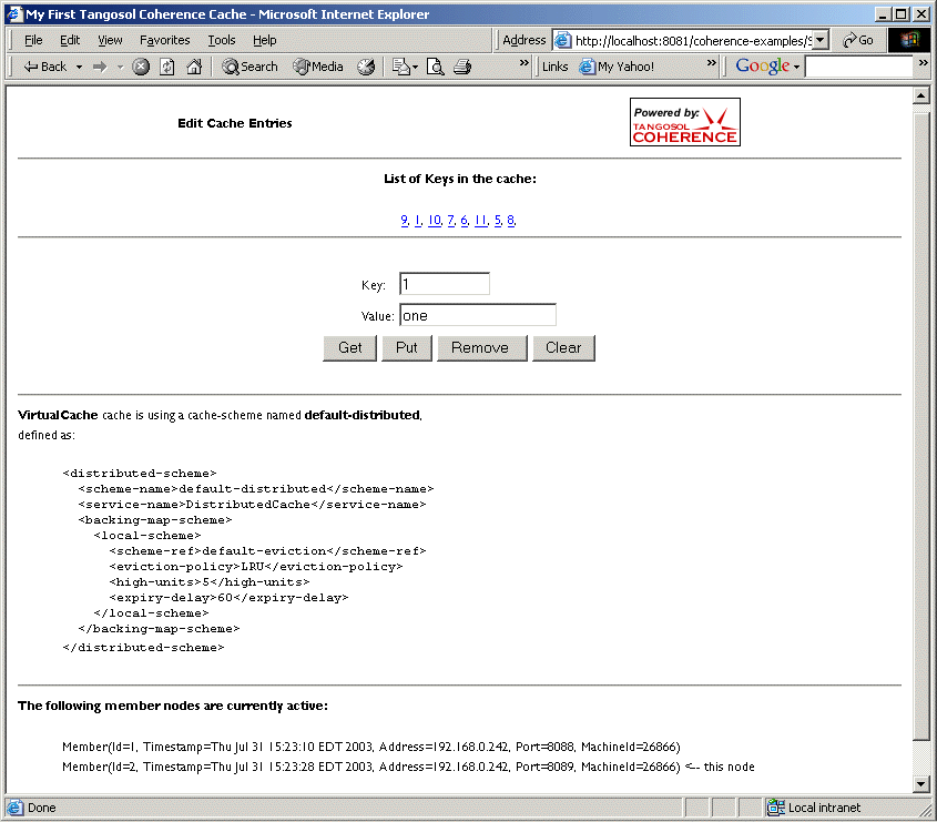

Now let's add an eviction policy for our default distributed cache, limiting it's size to 5 entries (per node) and setting the entry expiry to 60 seconds with an LRU eviction policy. To do that we need to make the following (bolded) changes to our descriptor:

Please note that we defined a general purpose local-scheme 'default-eviction' (with no size limit, 5 minute expiry and a HYBRID eviction policy) and then used it by reference (using scheme-ref) for our default-distributed scheme definition, overriding it's configuration settings to match our requirements.
Command: info >> VirtualCache cache is using a cache-scheme named 'default-distributed' defined as: default-distributed DistributedCache default-eviction LRU 5 60 >> The following member nodes are currently active: Member(Id=1, Timestamp=Mon Jun 27 09:50:07 EDT 2005, Address=192.168.0.247, Port=8088, MachineId=26871) Member(Id=2, Timestamp=Mon Jun 27 09:50:17 EDT 2005, Address=192.168.0.247, Port=8089, MachineId=26871) <-- this node Command:
Try doing some puts and gets, carefully noting the time you last updated the specific entries. You should see that the number of entries does not exceed 5 entries per node (so if you have 2 nodes running the number of entries should not exceed 10, for 3 nodes - 15, and so on) and entries either expire after they have not been updated for 60 seconds, or when you add the 6th entry (with the least recently touched entries being 'evicted' from the cache first. (Hint: use the 'keys' command in the SimpleCacheExplorer.java to see the list of keys in the cache.)
