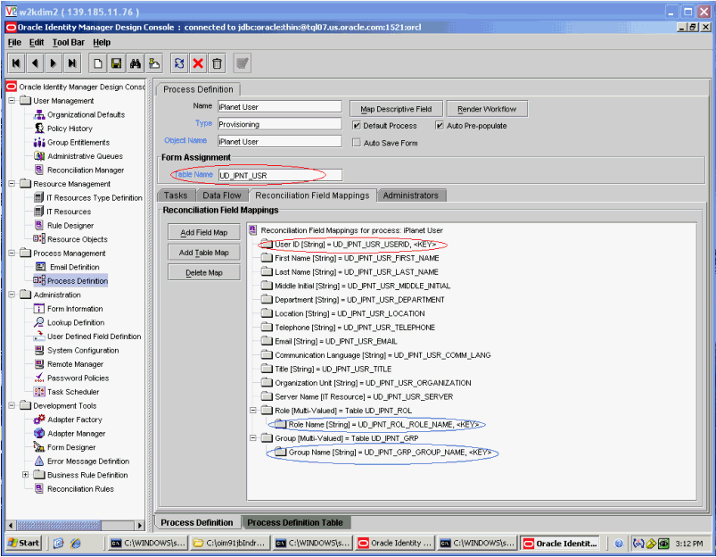

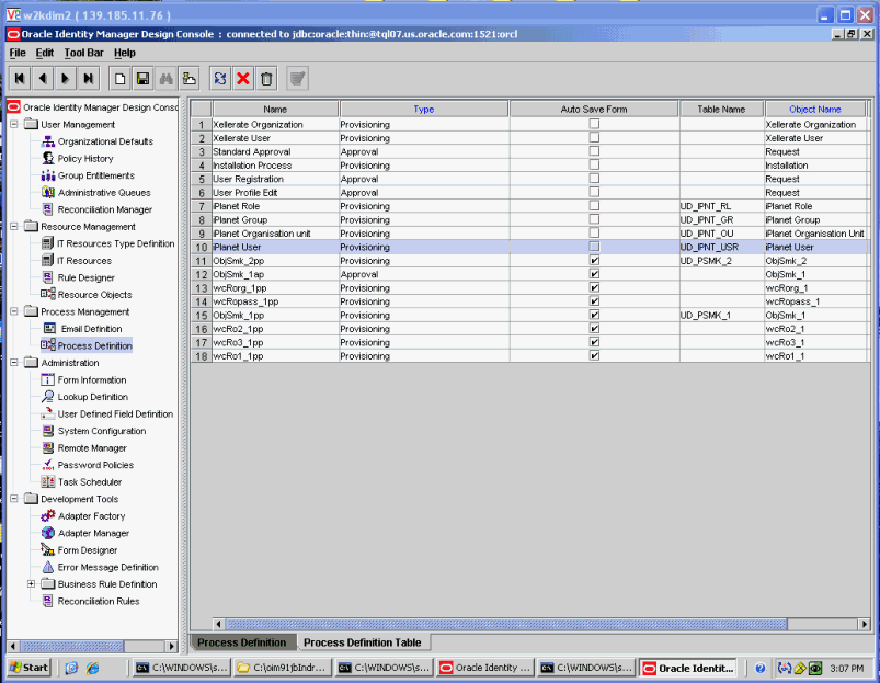

Figure 3-1 shows the process definition table for the Sun Java System Directory connector in the Design Console. For this connector, double-click the iPlanet User provisioning process, and then click the Reconciliation Field Mappings tab to view the field mappings
Figure 3-1 Key Fields of a Process Definition Table
Figure 3-2 shows the reconciliation field mappings for the Sun Java System Directory connector. In this figure, the table name and the key field are highlighted in red. For this connector, the UD_IPNT_USR_USERID column must be indexed.

The key fields from the child tables must also be indexed. In Figure 3-2, the key fields for child tables are highlighted in blue. For the Sun Java System Directory connector, the UD_IPNT_ROL_ROLE_NAME and UD_IPNT_GRP_GROUP_NAME columns should be indexed.
