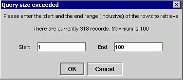

If you have both read and write access to all forms and records in the Design Console in the System Configuration form (that is, if you are a system administrator), you can set the maximum number of records that are displayed in the result set for a search. If the number of records retrieved for a search exceeds this value, the Design Console displays the Query size exceeded dialog box, as shown in Figure 3-5.
Figure 3-5 Query Size Exceeded Dialog Box
You are prompted to enter a specific range or subset of the result set to be viewed. In Figure 3-5, the maximum result set of 100 has been exceeded. Only records 1 through 100 will be displayed.
