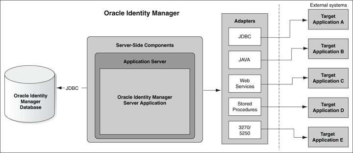

5.1 Provisioning Configuration
You can use Oracle Identity Manager to create, maintain, and delete users on target systems. In this configuration, Oracle Identity Manager acts as the front-end entry point for managing all the user data on the target systems. After accounts are provisioned, the users for whom the accounts have been provisioned can access the target systems without any interaction with Oracle Identity Manager. This is the provisioning configuration of Oracle Identity Manager.
The purpose of provisioning is to automate the creation and maintenance of users on target systems. Provisioning is also used to accommodate any requirement for workflow approvals and auditing that can be a component of that provisioning life cycle. Figure 5-1 illustrates the working of the provisioning module.
Figure 5-1 Provisioning Configuration
Description of Figure 5-1 follows
Description of "Figure 5-1 Provisioning Configuration"
Provisioning events can be started through any of the following ways:
